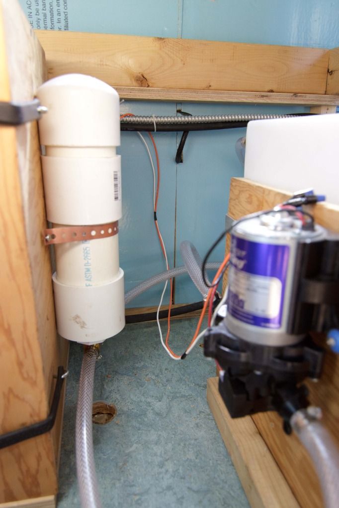

I also sanded, primed and painted my rusty wheelchair door frame, patched a big chip at the back corner of the body and built an accumulator for the water system. The idea is to trap some air in the system which will be compressed when the water pump runs. The next time water is needed the trapped air will force water out giving the water pump a rest. I just used some 4" PVC pipe with a tee at the bottom. It'll be a while before I can test it out.
Here's the body patch. I used Bondoglass to patch the chip then sanded it smooth with 80 grit sandpaper. after I took this shot I put on a coat of white gellcoat and tomorrow I'll sand out the gellcoat. Hopefully I won't have to put on another layer of gellcoat.
This is the cobbled up accumulator

Postby ol trunt » Sat Jun 09, 2012 8:56 pm
Your air tank should do the job. They used to use a vertical section of pipe next to the old fashioned radiators in buildings to buffer the energy of the steam going through the system. Worked then, works now. I still want your floor!

ol trunt wrote:Your air tank should do the job. They used to use a vertical section of pipe next to the old fashioned radiators in buildings to buffer the energy of the steam going through the system. Worked then, works now. I still want your floor!
Yeah, I couldn't think of any reason why it wouldn't work. All it's missing is the diaphram separating the air and water. In time air in the chamber might combine with the water so I put in a bleeder valve at the top to make it easier to drain down the water.
