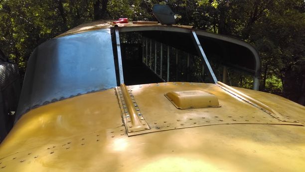

The transition is now in its final phase. what a relief. will now just need to make the seams look better and use bondo. Completed in 3 pieces with the middle overlapping each by about an 1". got the rivet gun working and the sides prepped for the the sheets to go up. hopefully the day of the bus getting sealed is next weekend. we'll see.
again was too cheap and didn't have all of the same color on hand. left side looks weird because of the way the sun is hitting it.
inside view.
