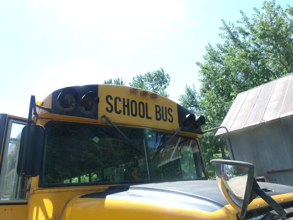

Progress this weekend was pretty good. in this picture we have removed the "emergency lights" by dot standards, we plan on for sure putting some type of custom glass in the back ones, but as for the front ones possibly just using the new welder to weld them shut or, glass of some kind there as well.

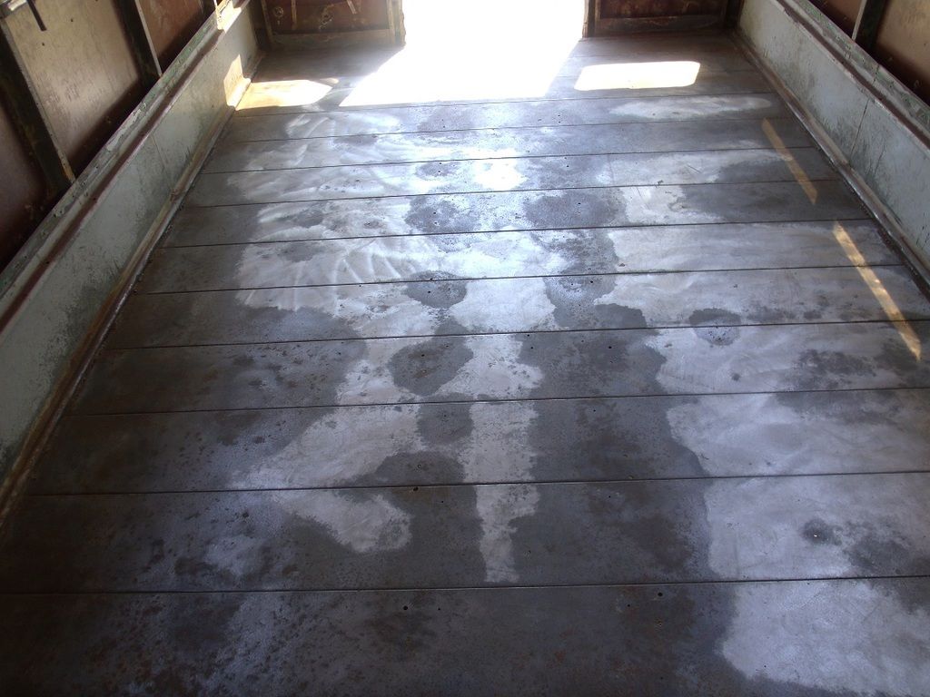

This is the 11' area behind the wheel well, it is very much now ready for Ospho then Rustoleum of some kind. was wire wheeled and sanded down pretty good, will fill all the seat holes with a good weld, which wont take more than maybe an hour or two to do it quick with this wire feed welder. we also scraped the rubber glue off of the seam of where the chair rail meets the floor then wire wheeled it and will be replaced with the same thing. not to bad looking for a 92' in minnesota.

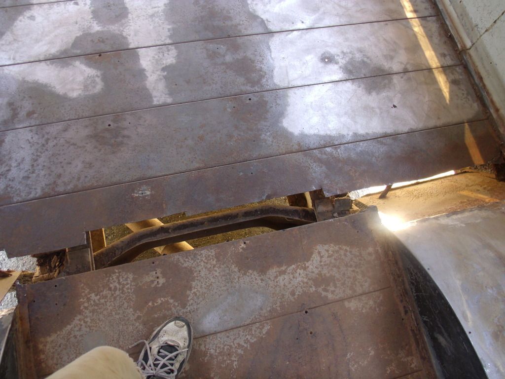

had to remove some rust of the floor, then further found out the rust was doing some serious damage to the angle iron in back of the wheel well and in front of it. removed both and will pick up a quick replacement at the local metal shop soon.

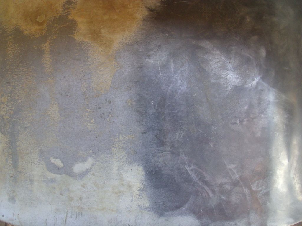

The rust was heaviest back here as you can see i saved the worst rust part of the floor until last.
