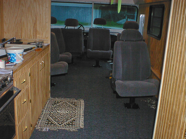

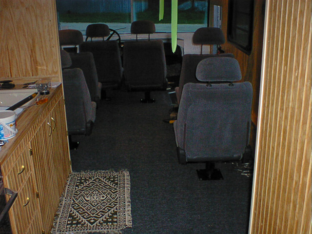

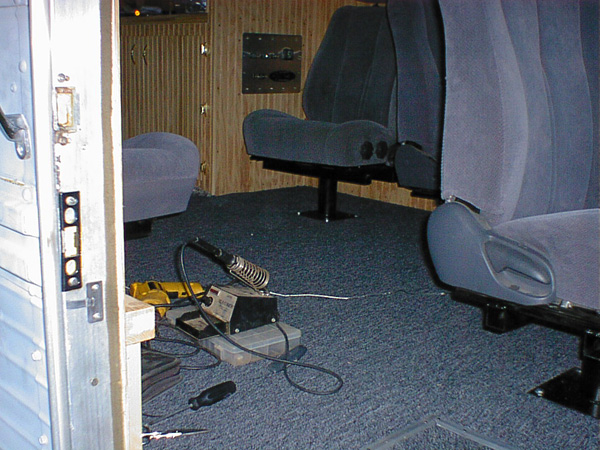

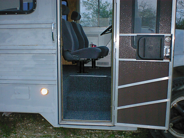

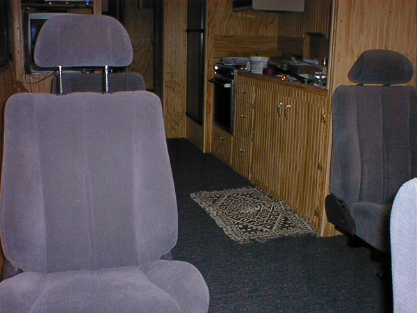

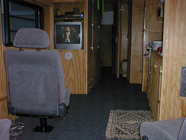

So, you step up to this old ugly primer bus and open the door and see this:
Step up and look back. Lots of crap on the floor.
Looking further back....looking better.
WHAT!!! The Matrix playing in 6.1 surround sound?
Standing in the back of the kitchen looking forward with seats in riding position.
Standing in the back of the kitchen looking forward with seats in "let's watch some TV position.
Still need seat belts and removable tables installed and curtians, but mostly finished on inside.

I like the carpeting, what kind of glue did you use in the stairwell to hold it on?

as a note, for the carpet in the stairwell in MY bus i didn't use glue. I used strategically placed self tapping sheet metal screws. They hide quite well in the carpet, and they hold great.

On the carpet attachment method, I borrowed a few tricks from the "Custom Van" conversions. The stairs were all sheetmetal and had some air/possible water leaks, so first I took it apart, sealed and reattached the metal. I covered the metal with 3/4" marine plywood for some insulation and sound deadening. Then, I simply stapled the carpet with 3/8" staples, then took the trusty hammer and made sure they were in all the way. I have restored quite a few VWs and the method of choice there is contact cement and thought about doing that, but figured the stairwell would be the most used area and may have to be replaced, so staples would be easier to deal with.
I have tried to use screws, but you have to be careful if you use closed loop carpet as the thread will wrap around the screw and pull a whole string out of your carpet and leave a bare streak! If you have open loop, screws will do well, but I would suggest you try with a piece of scrap first.
