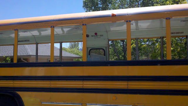

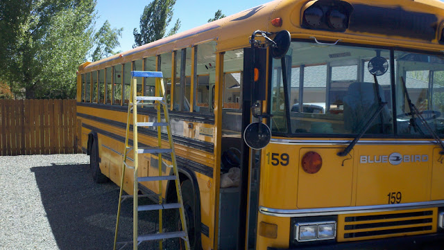

Got a little bit done this weekend....
Decided to pull the windows after all. The two windows I removed as a test a few weeks back ended up being the two hardest windows of them all. The only two we broke also. The rest of them came out without to much trouble.
Windows coming out.
Had to grind a few rivets at the eyebrow level. Well actually there was a ton of rivets.
I think I'm going to pull the exit door window and skin that entire square area.
Got them fitted and in place. Now we need to pull each panel down to glue and caulk them. RV style windows are on there way.
Ryan
