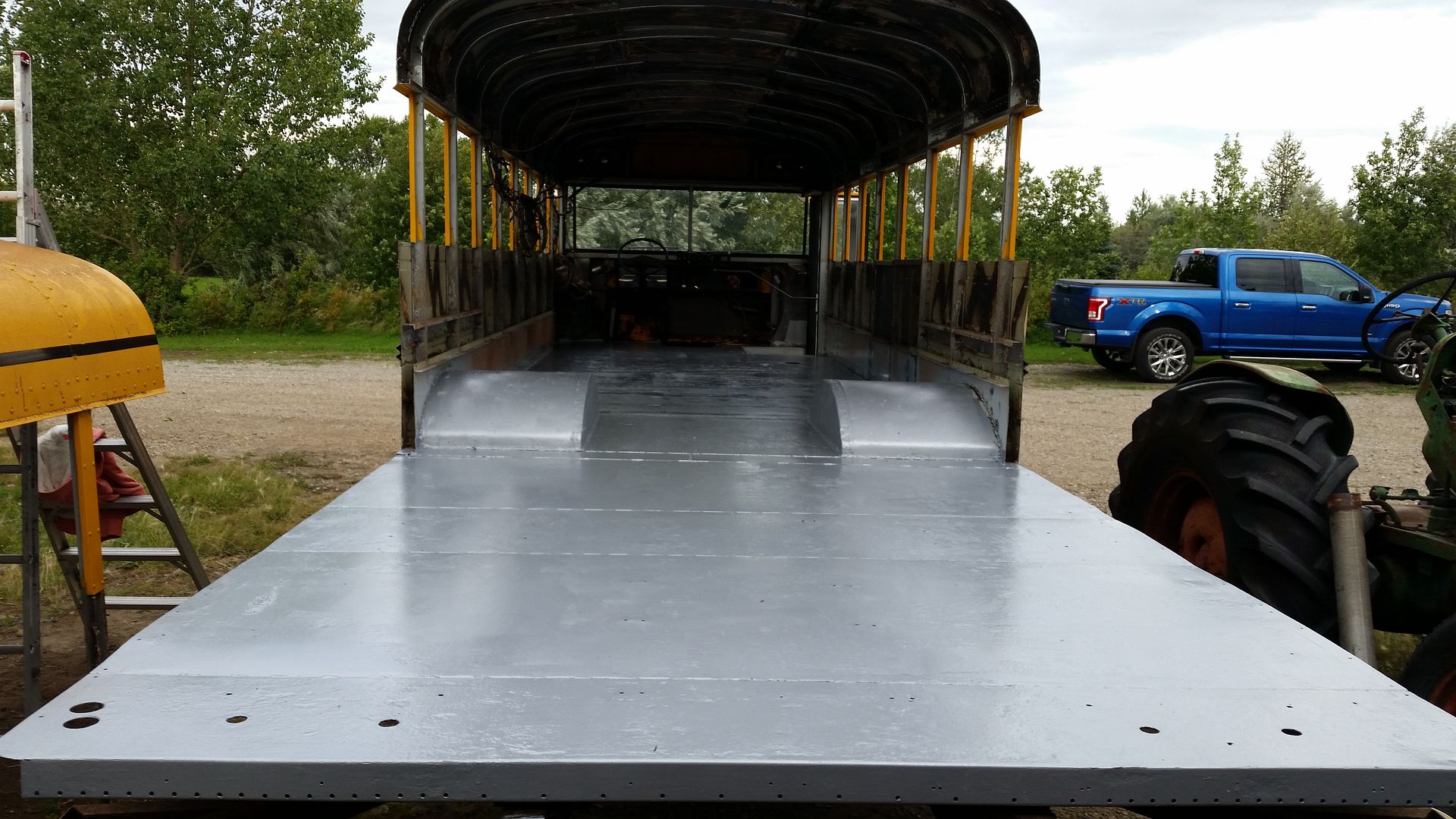

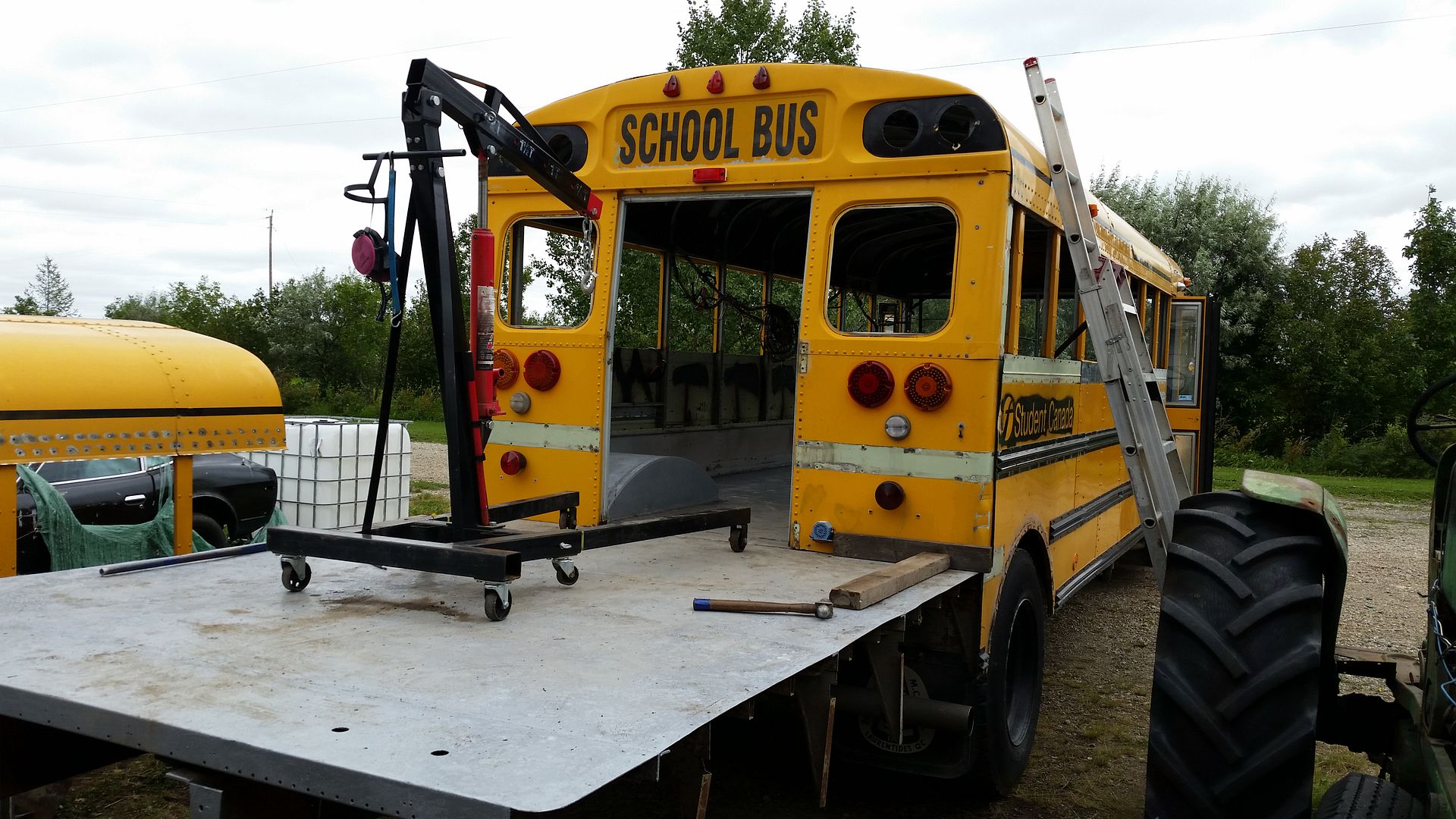

Got right to cutting the roof and the rear section out:
Help from the engine hoist:

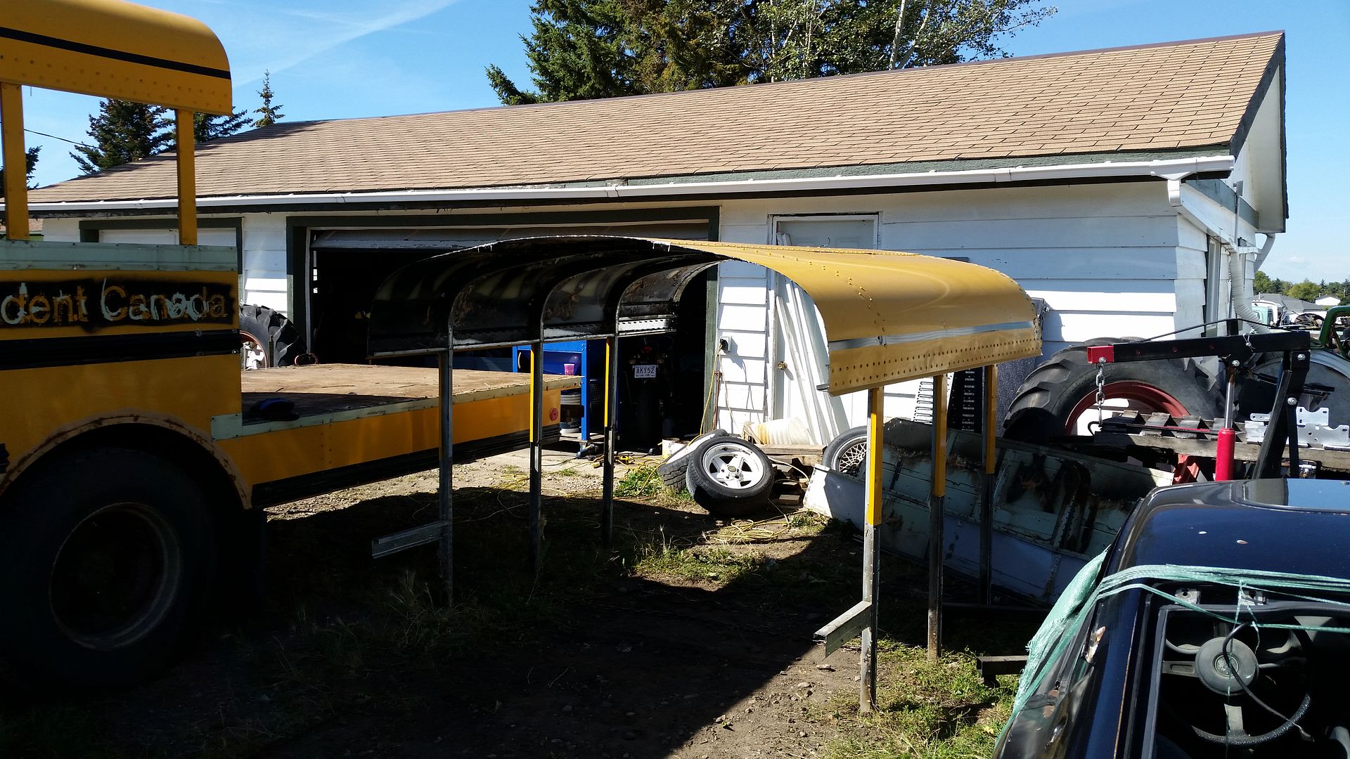

Then the side panels as they will be replaced by tool cabinets / storage bays:

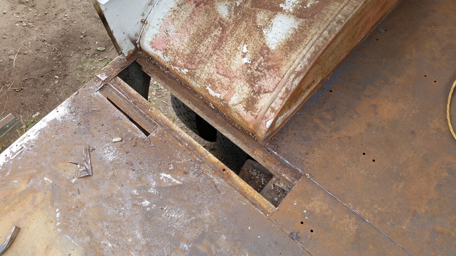

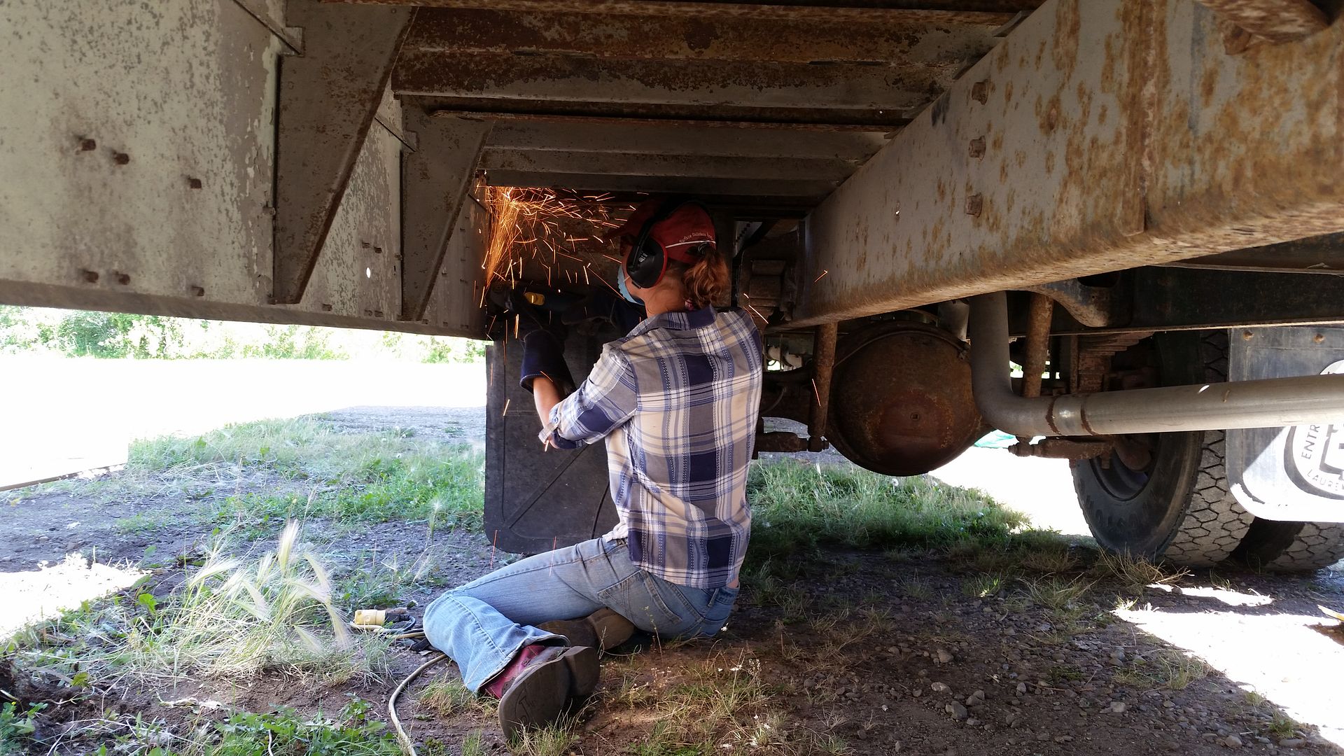

Then after flap wheel grinding / air chiseling the rust flakes off of the floor I found two main areas that had rusted through and I'm a big believer in doing it right so you only have to do it once.
Cut the pieces out, tack welded in the new ones and off to Metal Blast. I will be sealing everything from the bottom in the near future - before the underneath gets Spray Foamed.
As mentioned previously I purchased it through OnPoint Distribution. Awesome product and after following the instructions I applied a heavy coat of Rust Bullet. Great stuff, totally looking forward to the finished product.
Time wasn't on our side so I'll have to scuff it up and do a second coat later before being done with the Rust Bullet as per the instructions:

The goal was to get the back of the bus in place before the end of the weekend and we did just that. I'll have to buy some 9/32" rivets in a big quantity and a rivet gun that will handle that size but for now it has some self tapping screws holding it in place:
