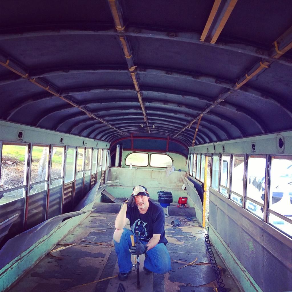

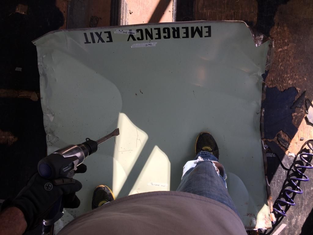

It's been a couple weeks since my last posts. I was just about to figure out how to remove the ceiling panels, and struggling with how the dang things come out. They were fitted in together snug as anything. So I decided to do the natural thing:
Bring out the big guns. Air compressor & air chisel.

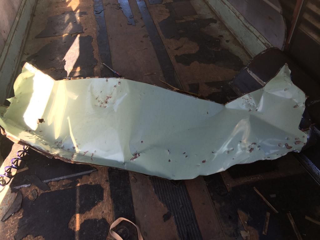

It was just a full on attack with little strategy at first. I just wanted to rip some steel open & see what I was dealing with. Ultimately, I saw that there were spot welds in about 15 places along each panel, with the panels tongued into grooves above the windows & the next panel.
I would crack in with the air chisel, then use a combination of the chisel, hammer, large screwdriver, and crowbar to extract each panel. Lots of jagged metal, only a little blood, I feel I came away pretty much victorious. Interestingly (frustratingly?) they installed the panels from the rear to the middle, and the front to the middle, so when I worked my way from the back to the front there was a point where the process I was using wasn't working anymore. I realized what they had done, cussed, called it a night & came back the next day & finished it.
12 hours of that & the ceiling was out. Easily the hardest part so far, and I'm beat up & sore. What's making it harder is a tendon issue in my left arm/wrist, rendering my left arm pretty much as a stabilizer/metal deflector/hammer target. Hit it a couple times, cussed, cussed some more, wondered what I was doing & was I crazy? and kept the assault on the ceiling going.
Ecstatic it's out! On to the next project!

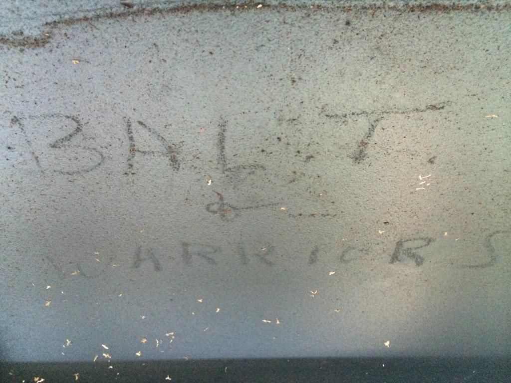

Oh...kind of a fun find:
41+ year old graffiti on the inside roof, hidden by the ceiling panels for 4 decades...Balt. Warriors? I'll add my own graffiti before I slap up the insulation & new ceiling!

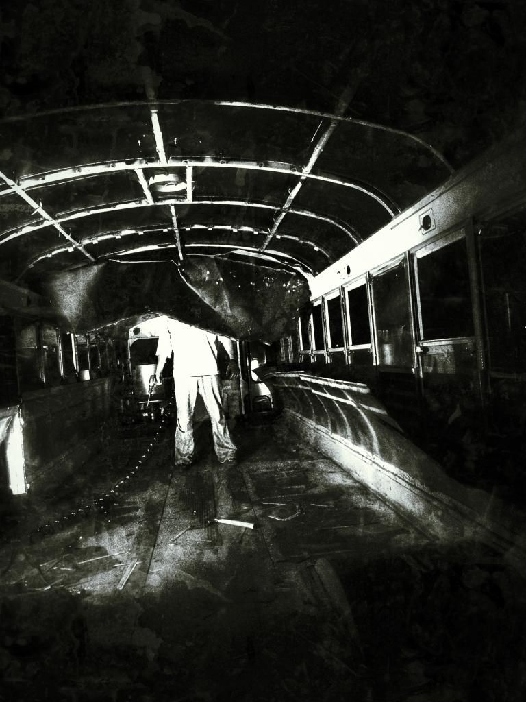

Next job to do is the side panels. In the previous post you can see where the panels have all been unscrewed & some loosened so that they're starting to bow in. I'm trying to figure out the strategy, because the Gilligites did it again: they built this bus like they knew Eastwood would be using it in "The Gauntlet."
The silver metal crinkly walls are welded to the lower green wall, which is in turn bent under to form the outer lip that the 3/4" plywood flooring sits on. Nasty! Beautiful design, obviously they never imagined some 5 year old (at the time) would be renovating it into his house! Beautiful but nasty.
So the plan (subject to change!) may be to torch or cut a line about 2" from the floor, from one end to the other, then lift both the silver panels (still attached to) the remaining green lower panel. After cleaning, sealing, insulating & putting up the wood walls, I'll just hide the ugly green part with matching moulding.
