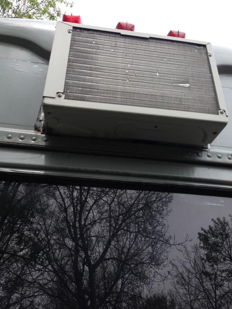

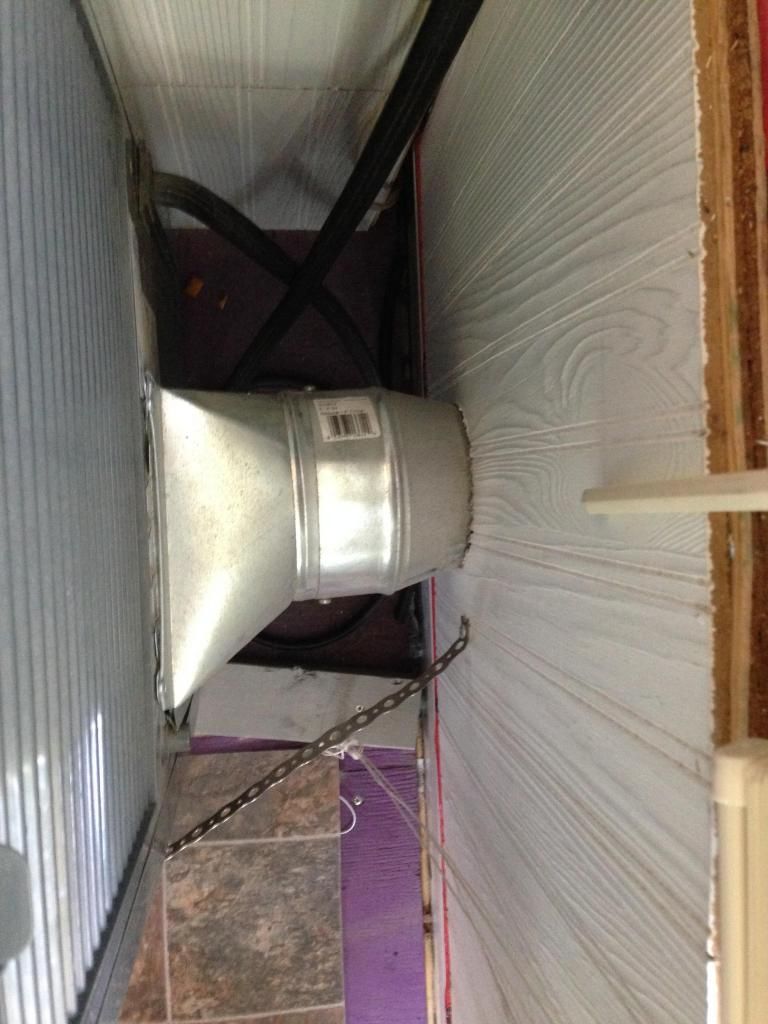

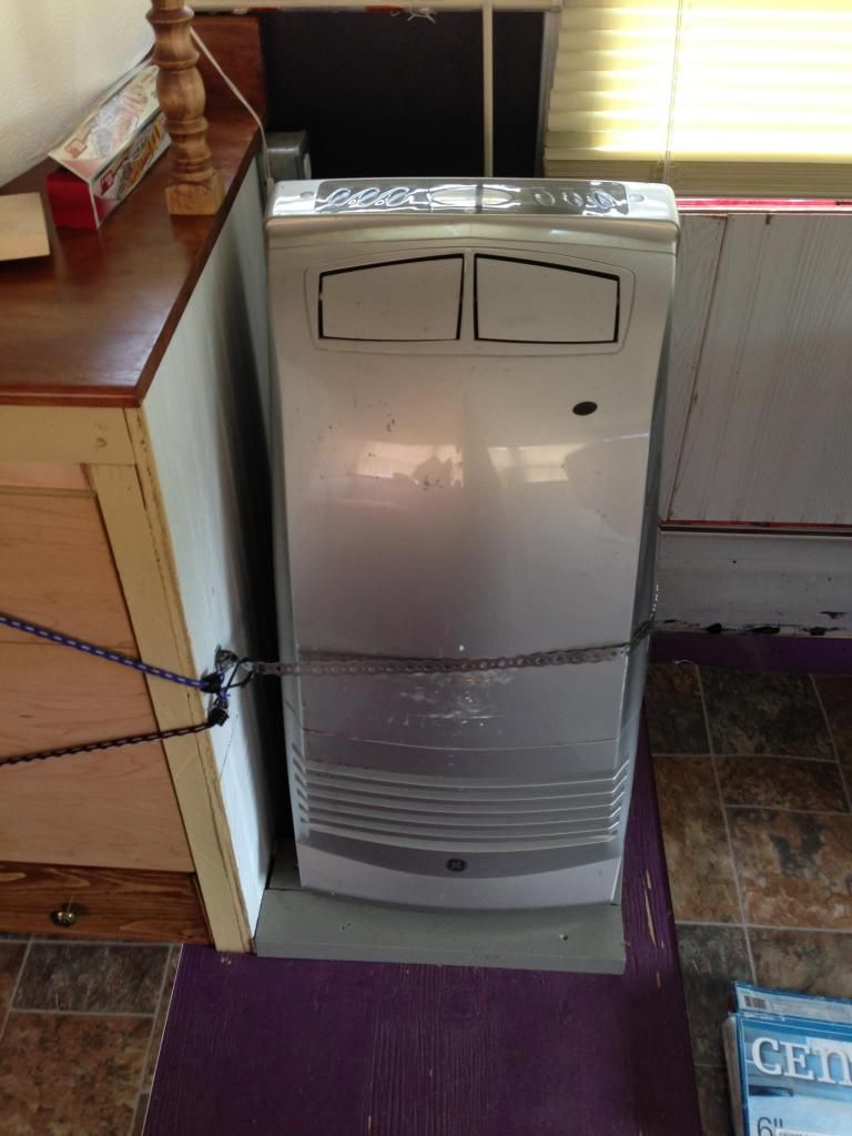

I was asked to show some pictures of my aircondtioners
front one is a 9000 btu portable type, I have 2x3 lumber screwed around the base to keep from moving, and a metal strap around it as well, on the back I got a furnace take off duct boot square on one end mounts to the exhaust , and then goes to 5 inch round out the side of the bus, works good,
front of a/c
exhaust hook up
this is the vent out the side, I don't have the screen on it
the rear a/c is just a reg 5000btu window model just cut hole and installed no biggy, and works great
