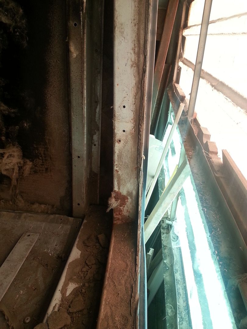

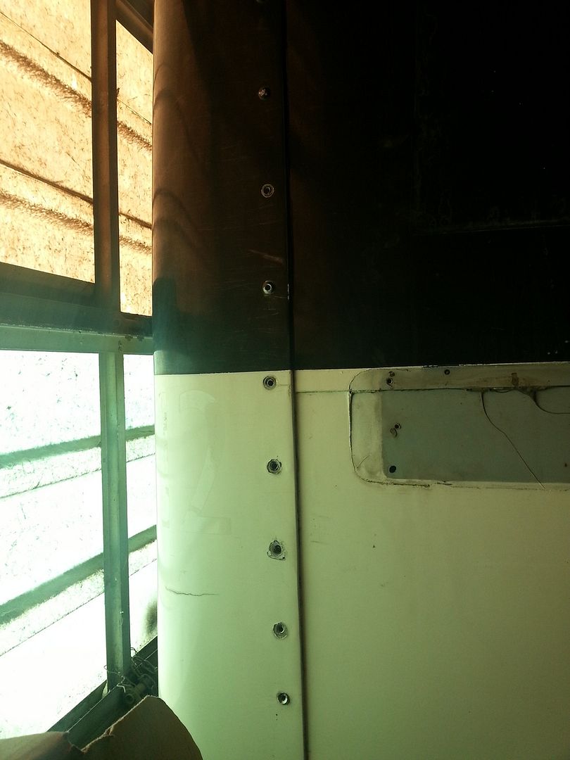

I'd like to replace the sheet metal all the way to the rear corner -- and it laps under that fiberglass. There will be a horizontal cut all the way through the fiberglass on each side of the rear window so the upper and lower sections can part for the roof raise. I'll be learning how to do fiberglass in order to extend at the cut location and also shrink the rear window opening.

If what you're talking about is a "Fein multi-tool" then I absolutely swear by them. They were the tool of choice with all the fiberglass work I used to do. You use a 3" cut-off blade on them. You can definitely "shave" fiberglass with them by taking cuts at a very shallow angle - it was like a wood plane but for fiberglass. Or you could get a nice straight cut right through. And you can hold it against your hand and not cut yourself.
For cutting BETWEEN things it's not quite as straightforward. Believe it or not, a good tool for that is actually a hacksaw blade held in your hand. You take long passes along the joint line and it shaves more than you realize out of the joint. 20-30 passes can make a surprisingly deep cut. Note that you're cutting with basically just one tooth here - sort of shaving out the adhesive from the joint. If the adhesive is rigid, this often works fairly well.

Yeah it looks like that Fein multi-tool is the same kind of thing. So if I'm being honest with myself, it'd be a fun tool to have but this particular step might not be the right excuse for buying one!
Actually this morning I started thinking about a hacksaw blade too. It looks like I might need to reach into the lap joint about 3" deep. Holding a blade with no frame is a pain, though, and blades are cheap enough.. I think I'll make a little frame and weld it to one side of the blade to make a very flush cutting tool. Being hand operated it'll be easier to avoid ruining anything in the blink of an eye.
