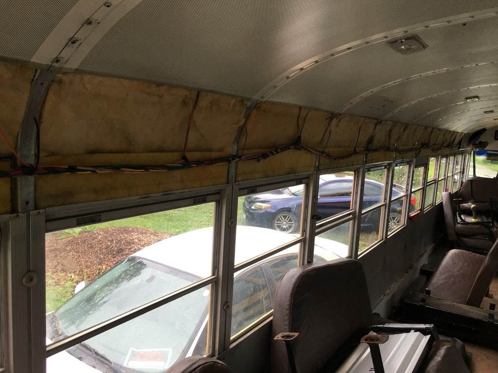

Hi guys, my name is Ryan. I live outside of Chicago and I just bought a bus! It's a 2001 Chevrolet Bluebird 65 Passenger with a CAT 3126 Diesel and Allison Auto. 115k on it originally from southern Missouri so it's very clean. I drove it home July 25th and managed to get all the seats out the next day in a couple hours...
So far everything has gone smoothly, but you never know what life will throw at ya! Here's a couple pictures I got of the bus and getting home
