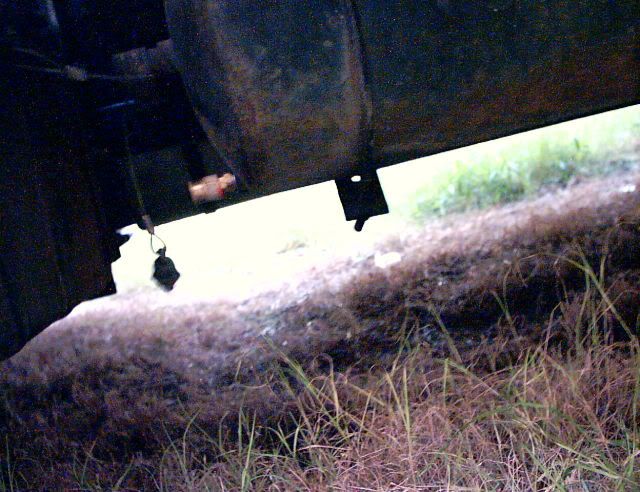

I just did my 1988 international truck. It already had a 1/4" water drain in the tank, I just unscrewed it and screwed in a 1/4" quick disconnect w/ some teflon tape. $4 from home depot. Works great. I was gonna put a tee and drain, but there wasn't room, so I will just drain it with male air fitting now and then.
Funny thing is this truck doesn't even have air brakes. The only thing that runs on air is the air bags that lower the truck, which I don't even use. Whatever, though.

Re: Hooking up air hose / air tool to the air break compressors?
Is that a Gremlin Bell I see dangling beside the air tank?
Good idea if it is! Keep the nasty beasties away!
It does look like a bell. That is the old air drain valve hanging by the pull cord.

RyanS: you have it half right. Put a male quick connect on the bus, where your photo shows a female. Your valve will then drain the air tank normally, without any further connections. Every bus I've ever seen (granted not that many) has it set up this way. Make sure and have a ball valve, which should have been there originally to drain the tank.

But putting a male fitting on will make it backwards to the way most systems are plumbed requiring either a double-ended female adapter or putting a female end on all the air tools. Ideally you would put a T in it with one end facing up and the other down. On each side of the T would be a ball valve and you would put a female quick connect above the upper ball valve. That way you could drain through the bottom, run your air tools off the top (without nearly as much condensate), and you would be able to isolate either to assure that you won't have leakdown.

About my air chuck- I know about condesation and how this was a drain for the tank, however the main factor is that I am a super lazy-ass
