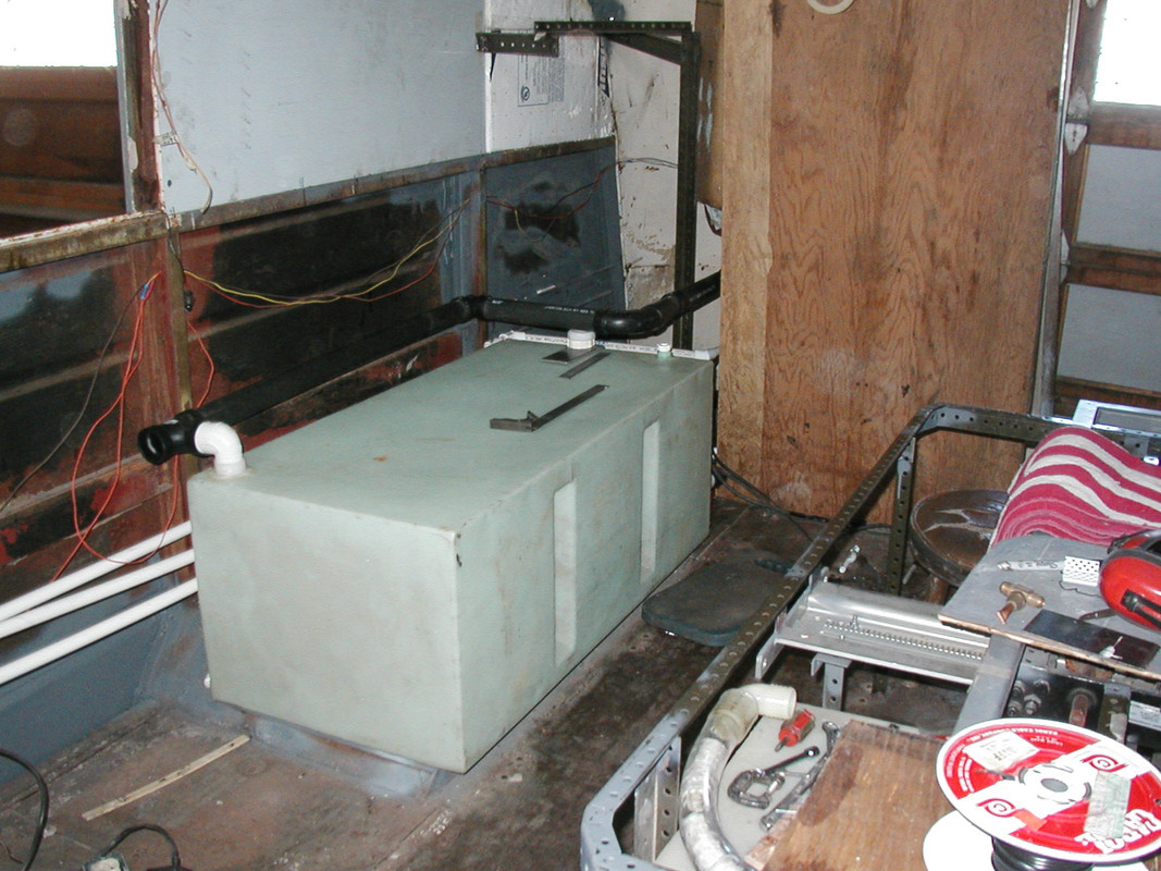

The fresh tanks work fine for grey as well. All my tanks were used so nearly all the openings were in the wrong place.I was able to get spin weld fittings nearby so I set about rigging up my own spin tool--the router thingy. A word of caution. a router turns at about 25,000 rpm's and when the replacement plug or new fitting touch the tank, both touching surfaces become molten and until you get the hang of spin welding its easy to get a bath of blistering hot plastic--I sure did!
This is my 40 gallon grey tank with various home done spin weld fittings.
