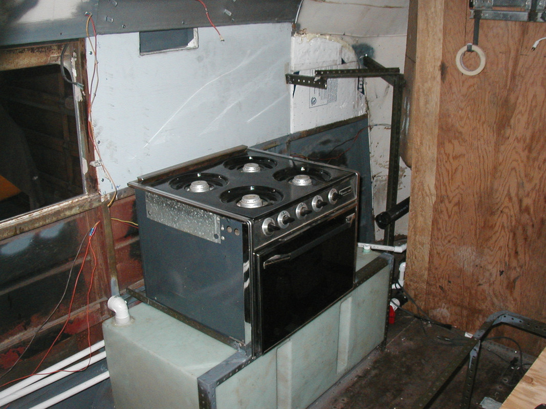

Ours is a 35 gallon tank midshipped under the bed.
The Roach Motel
