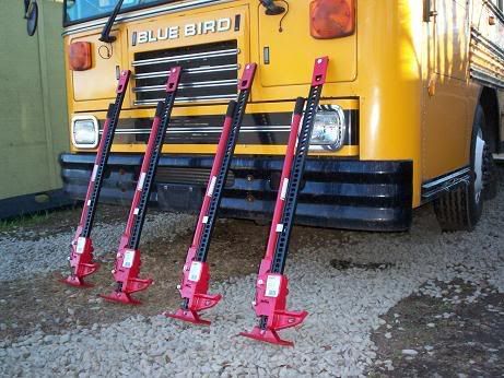

And this week I have a new love in my life. Her name is Big Cutoff Saw. With three blades, she cost $100 a night, but WOW. Cut the trailer hitch off the old bus like it was cardboard. Cut the tow hooks and related extensions and cross member off Millicent like it was paper. Trailer hitch will go in the middle of the frame, to minimize scraping.
Millicent is remarkably rust free, even for around here. All the bumper bolts just unscrewed without struggle (with 1/2" air wrench, of course).
Ah, the roof lift. Purchased four "farm jacks" from Tractor Supply Co. Less than $30 each. Like bumper jacks, but better. Took out some windows and ceiling chase and studied the innards. Designed lift mechanism and extension inserts. Off to the steel store!

At this point, the work consists of preparing the four Lift Rams for the jacks to push against, and the four Guide Tubes that keep the Lift Rams, and thus the roof, going straight up and staying straight. Then there are 30 Inserts that fit inside the severed window posts. The lift will be 22.5 inches. This accomodates a 48" sheet of material for outer skin. The Inserts are 29" long and will stick into the window posts about 3 inches top and bottom. So the roof will have to go up 29" and back down 6,5.
I think I have it all figured out! :P
