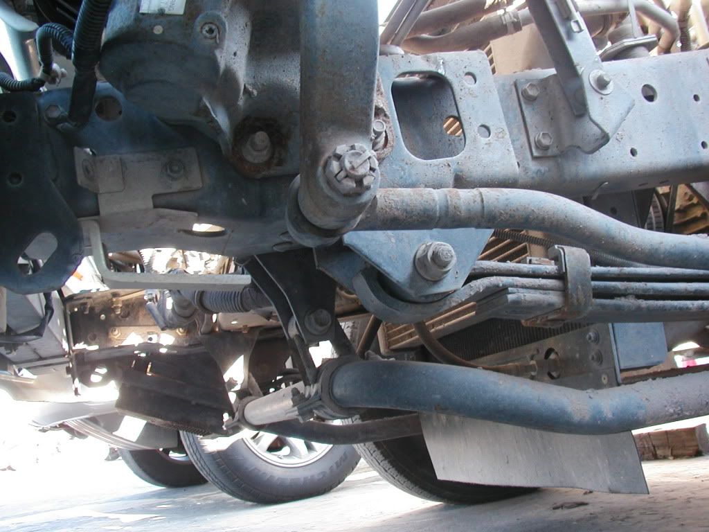

Back to the devils. I managed to get the steering gear repositioned behind the wheel. The bracket is a sandwich 3/4 inch thick at the frame and secured with grade 8 bolts. The drag link had to be shortened about 4 inches. It is solid and was butt welded, sleeved and plug welded using the proper technique and works just fine. So much for devil #3--I hope. Devil #5, the wiring was not as much work as I had thought it would be. I only had to R&R the radiator/intercooler and the steering gear. I now have plenty of wire to reach the dash board.[[b] The original steering gear location is about where the front bumper should be[b/]
