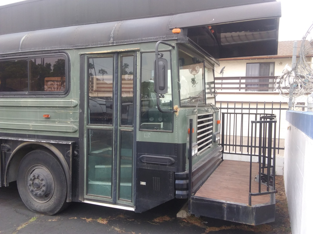

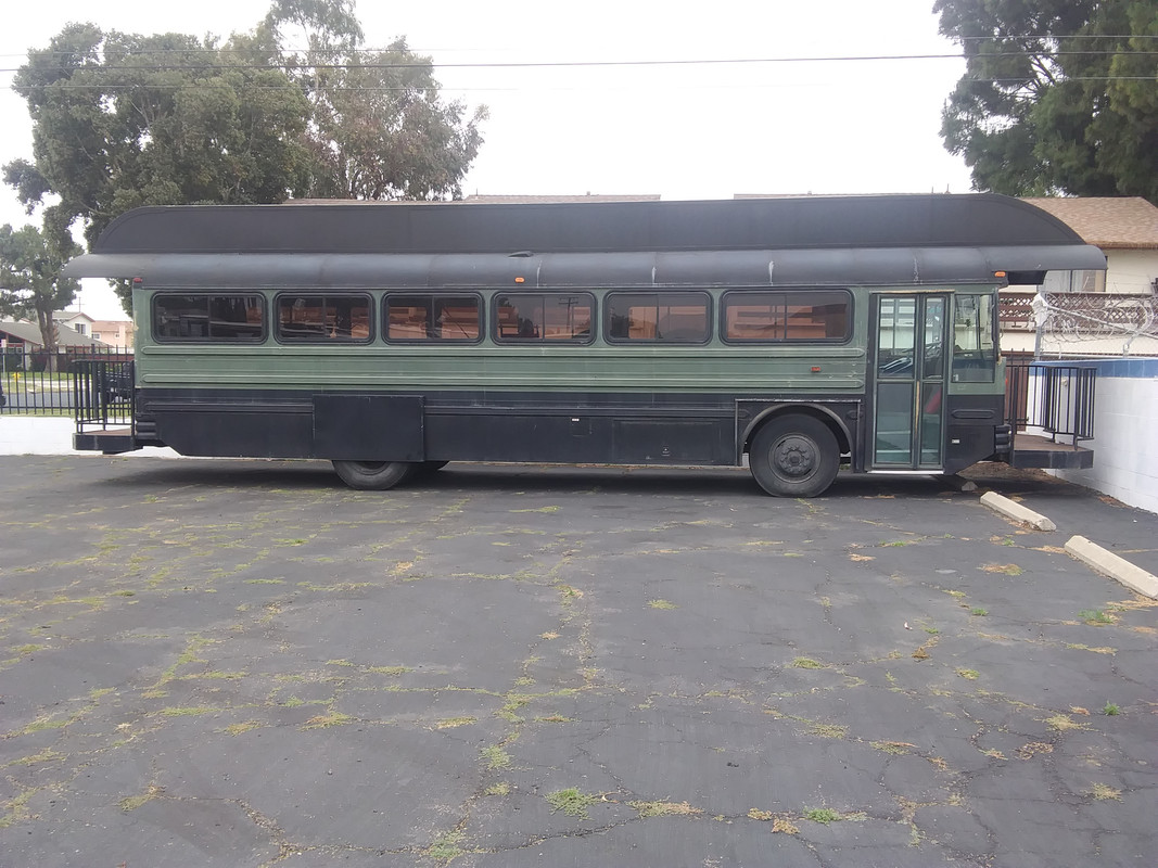

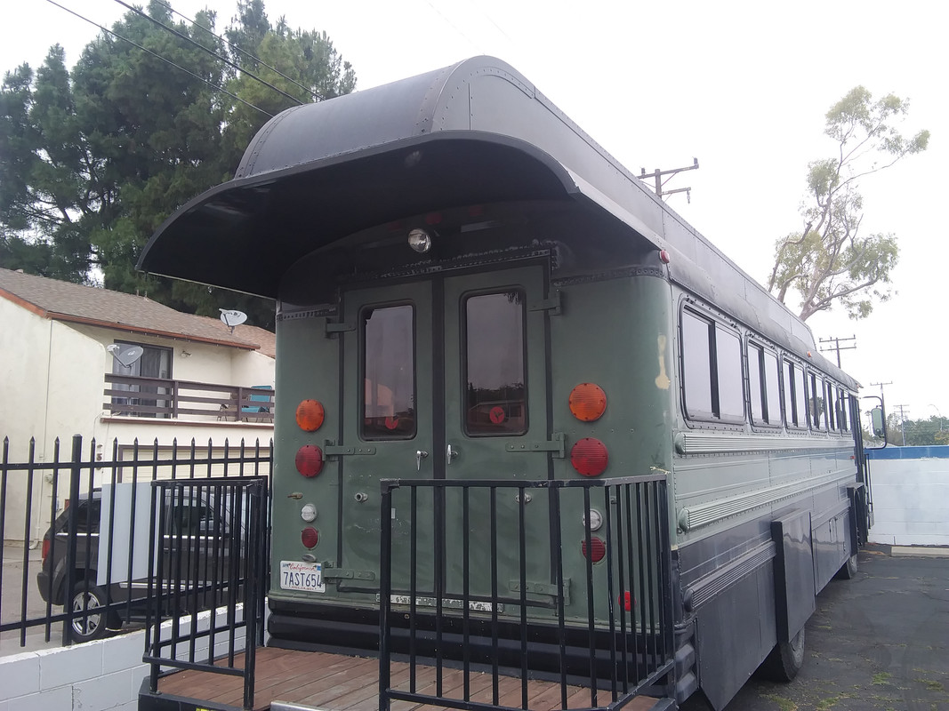

I've posted this picture before but we all know how hard it is to access info on old posts so here goes---again
Jack
If I could find a place to store it, this is the bus I'd like to have.
