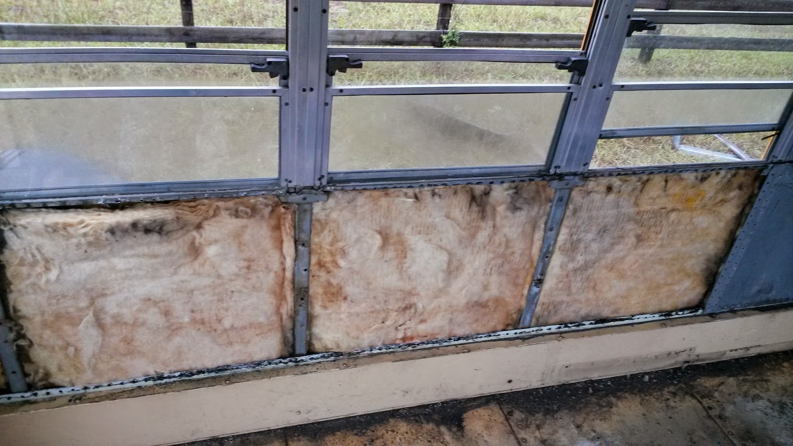

My bus is a 1992 Ward Senator on International Chassis, with DT466 Diesel and Allison transmission. Drove her home on February 3rd 2017 and started work. This will be a straight-forward post, just a few pictures to show what I'm starting with, then I'll add more info and more pics as I go along for anyone interested. Please feel free to ask questions and I'll answer with what I can. I don't know a lot about these buses but I'm a fast learner. I'm also looking for any schematics, service manuals, etc. so that I can learn more and be better able to work on my bus. I guess my first objective is cleanup and organize what I have so I will know where to start with the conversion. I'm attaching a picture of my bus, and some pictures from the inside to show what it was like when I bought it. I've cleaned it up considerably already and will post more pictures soon.

Yep, I love it already! I pulled down 4 13-gallon bags of insulation and went back over it with a scrub brush to get all the little bits down so the roof is clean now. I wore a particulate mask with filters good for asbestos, insulation, etc. I then went over it with my little 1 gallon shopvac and sucked up all the insulation off the seats and parts of the floor. The seats were a mangled mess in the back and I couldn't even walk to the back door so I set them back up along the rails and pushed them really close together to take up less space, and so I could see what I've got. I need to decide if I'm going to keep any of them for road seats while driving for wife and daughter. Quite a few are in very good shape with only 5 or 6 with small holes/tears and 1 with an end seam split open.
So far, the only leaks I've found are around my strobe light on the back, which is right behind my back hatch. I'm going to get the ladder in there soon and remove that. The second leak is the front hatch. It's in horrible shape and is probably original. Seems to be cracked somewhere to let water inside it which then leaks around the knob which opens the emergency part.
I didn't take the wall panels off yet. I'm not sure if I want to, at least for a while. I did remove my stop sign today, and unplugged all the emergency exit switches so the buzzers aren't sounding off now. I'll try to take some more pictures tomorrow of the progress and get them posted.
