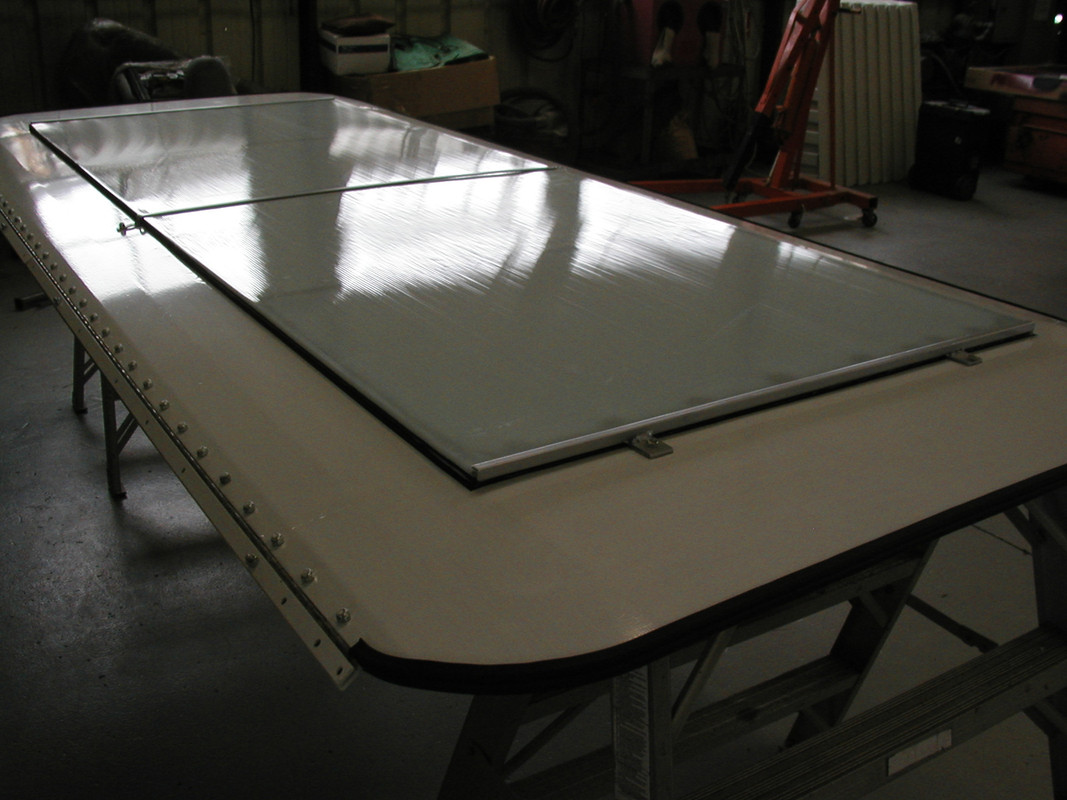

Tomorrow I should be able to rivet on the latch cover and the piece of 1/4" Lexan I have for this and be done with the thing. Just in time for 10 days of no rain to test out whether or not it's really watertight.
Old 07-22-2021, 08:18 PM   #2048
Posts: 6,719
Did an experiment (fortunately) riveting 1/4" Lexan to some plastic from my roof hatch with 3/16" SS rivets.
Complete fail. I guess the plastic is too soft and the SS deforms through the hole and the piece pulls right out.
I guess I need to try this with aluminum rivets or just use screws.

Two dabs of construction adhesive and Dynatron-570 (the white stuff!) around the edges to seal it.
Decided to use 3/4" #12 SS machine screws to attach to the plastic of the hatch. They grip pretty well and a lot easier than riveting anyway.
Cut the plexiglass to fit around the latch cover and the rounded corners.
Marked out the screw holes (every 2").
Lexan is so easy to drill. Love this stuff.
Ran in two screws to hold it in place and then drilled the rest of the pilot holes in the hatch.
Bead of Dynatron-570 around the edges. I decided not to use construction adhesive as well as screws since it doesn't really seem to adhere too well to Lexan and I think (hope) the screws will be sufficient.
All screwed in and glopped up. I got good squeeze-out all around with the edge bead, so I think this thing will be watertight - at least initially. My big concern will be what happens to it after it sits in direct sunlight all day for a long time.
Looks good from the underside, which is all I care about.
We're supposed to get some thunderstorms tomorrow night, so I'll install this on the bus tomorrow and see how it does.

Bored this morning so I decided to go over and install the skyhatch.
The Lexan got a little scuffed at some point (probably from the band saw) but it's not super-noticeable.
Another happy accident: the other hatch fits perfectly under the couch. The Lexan is pretty heavy, so both of these hatches weigh about the same amount.
Since I'm not 100% confident yet that the skyhatch doesn't leak.
I like how it's not visible from the outside that this is anything but an ordinary emergency hatch.
First time since I've owned the bus that nobody can break in without literally breaking something (or picking the MasterLock on the door, I guess).
