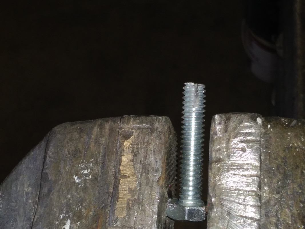

I have had good luck using the actual screw as it's own thread chaser. I clean things up as best I can with a wire brush and rinse with WD-40 or mineral spirits. Next I cut a slice in the screw thread perpendicular to the thread until there is a slot (like on an actual tap). A light touch works best for starting the cut. At this point all you have to do is start the screw in a bit, back it out a bit, add thinner, start again etc. The process makes any screw a self tapper. It is a little tricky getting the hang of cutting the slot but with the screw firmly held in a vice and using a thin hacksaw blade even the smallest screws can be made into self tappers.
This is a 1/4" 20 screw:
Good call!! The relief cut allows a place for the chips/debris to go with out gaulding the threads just like a tap!
