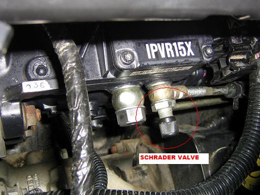

So, spent a night reading, am now expert in Cummins 5.9L gen 2 24v Bosch VP44 fuel delivery system.
First, none of the crap you need to get to on this motor is accessible without removing untreated parts. Lift pump removal?- remove starter. Injection pump service?- remove air compressor. There is more room in a Honda Fit engine bay. You would think that with the 'smaller' 5.9L that there would be an inch or 2 to get your hands in there, nope. 40' of vehicle, lets put the air governor on TOP of the compressor.
Air inside lines of diesel= bad, no go. 5.9L is prone to having the o-rings in the filter bowl dry out- for the big filter lid, WIF (water in filter sensor), heater and flip-drain. Some VP44 have a JIC-4 Schrader valve type connection (same as A/C charging hose) for air bleeding and ez fuel pressure gauge hookup, but on ole' Succubus, no room for that feature because of proximity of engine mounted air compressor for air brakes.
Bluebird busses with center frame mount tanks (mine, 60 gal) are notorious for having fuel supply problems, and if the VP-44 is starved, it will suck the fuel until it burns itself out- $$$$. Dodge Ram guys put inline electric pumps to boost supply pressure and bypass crappy carter stock pump. The other essential mod is a fuel pressure gauge/idiot light combo. Mine does show a sensor coming out of banjo fitting on filter canister, but until it's running, won't know status of that. Fuel pressure varies with conditions- load/temp/hills/inertia... Carter fuel pump is whiny, inconsistent sounding...i hope (pray) is culprit in my case.
VP44 is a mechanical pump, controlled electronically by EDC (electronic control unit) on the top of pump. Similar Bosch pumps ubiquitous in Europe, so they are clear experts. When Bosch switched to dreaded Pb-free solder, same problems arose as in aircraft- bad solder joints. There is a $2 transistor (drive transistor) in that computer that gets toasted that prevents the pump from communicating. In a Ram pickup, the repair can be done in situ, without removing pump. EDC is like an electronic distributor, taking info from crank sensor to determine which cylinder gets a squirt of fuel and when. Pump removal required, of course for Bluebird. Majority of bad VP44 injection pumps are due to this electronic failure. Supposebly, Bosch fixed this issue...eventually.Cannot swap EDC as they are programmed for specific application/engine.
Courtesy of WoodButcher. EDC is under cover below big IPVR... sticker
EDC removal
EDC Repair process

Plan of attack is to put some dye in 5 gallons of fuel, add to tank, and pressurize to a few-3 to 5 lbs psi to see where she squirts. I have drips from previously leaking frame-mount water separator, so need to distinguish old drips from new. They also have tap off of fuel sep. for genny, to complicate issues and introduce dreaded air. I take brass fuel cap, drill hole and put in Schrader valve to pressurize. More is less, here- do not go crazy with 80psi...
I should just put FASS or Raptor or Holley Blue inline pump while I have air in lines and need purge , but I need to hear it rumble before it gets any more cash from me.
In Dodge Rams, they remove black flex line from lift pump to Inj pump and temporarily put 5 feet of clear 5/8 tubing in 2 loops on windshield so you can see if air in lines as you drive. I have braided steel connection i won't cut for insertion of tubing... Even just a tiny pinhole in gas tank pickup tube or a bad check valve can introduce air into system.

Excellent info Rusty...thanks for posting. Unless you are building a sled pulling diesel and don't mind blowing it up at every event by pushing the RPM's...the guidelines above are what you need to build to...and run at. Folks new to diesels think they have to drive them like they do their cars...more RPMs = more power. NOT.

I used a Raptor lift pump on a GM/DD 6.5L to good effect. Simple, adjustable, outlived the truck.
Also, there exists "sight glass" for rigging a clear section of fuel supply to check for air and whatnot. Better/safer then clear tubing from the box store. Inexpensive. Try mcmaster or similar.
Is fuel supply on this thing a dumb-loop (with unmetered supply and return diesel lines), or some kinda fancy "suck-the-exact-right-amount" fuel system?
I guess I lost track of what problem your solving here? Why not replace with fresh diesel, prime, check fuel pressure and then try to fire the beast up?
