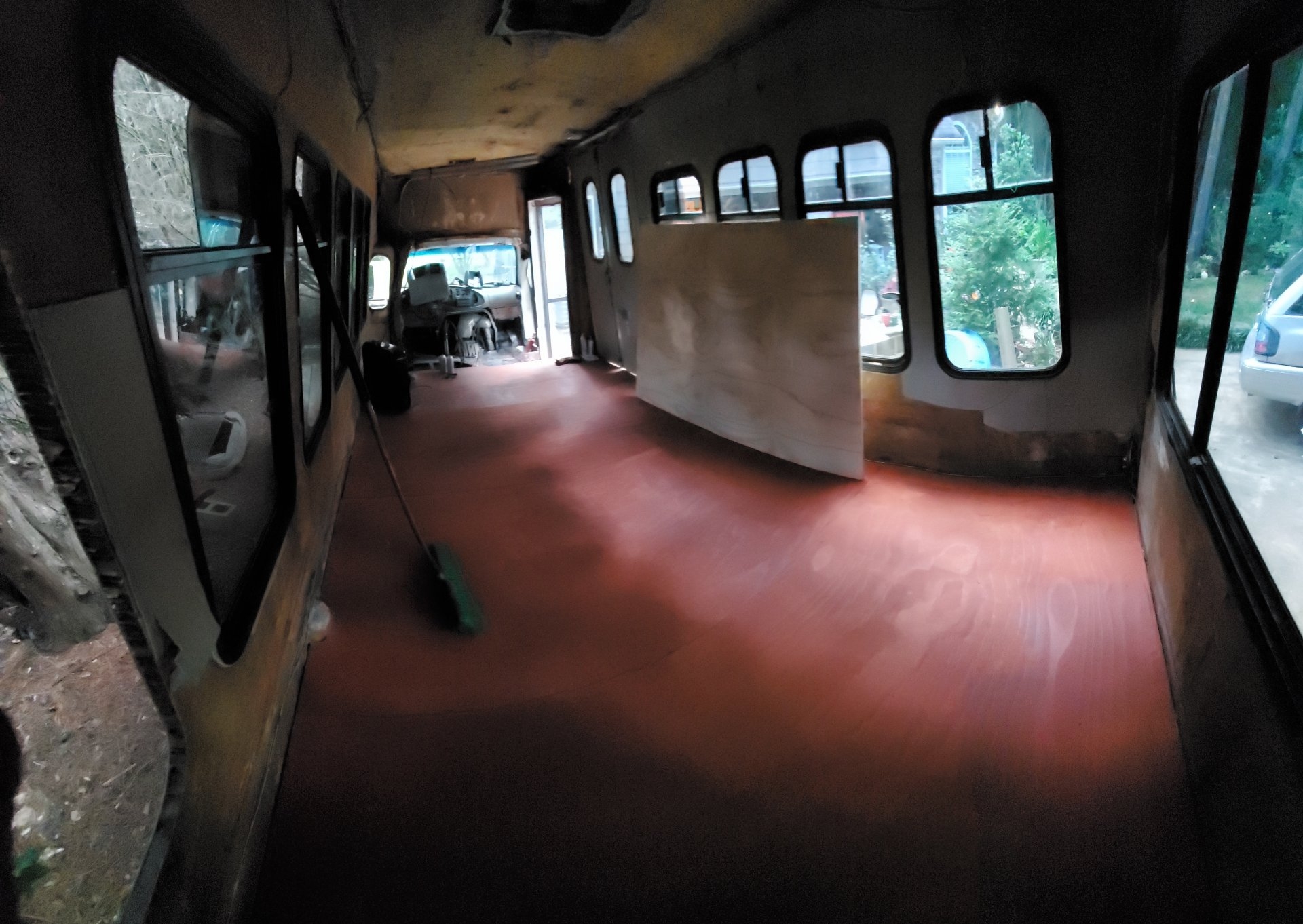

anyway, moving on.
Is there such a thing as good rust? Got it gone from the driver seat back and replaced, laid down 3/4 ply water sealed and screwed down.

That is a huge job...but you're doing nice work and the end result is going to be something you know inside and out (literally) and in which you can have confidence. There's a lot to be said for that. Mad props, as the hip kids say nowadays.
