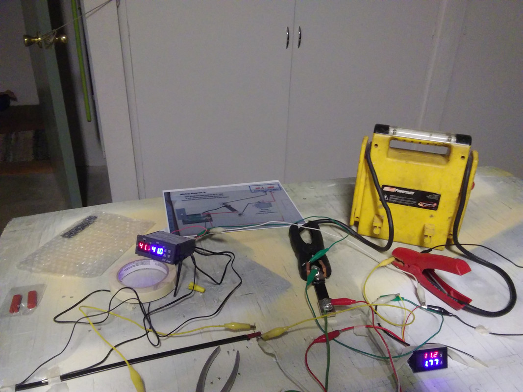

Even with my fresh and grey water tanks inside the bus I very nearly had a pipe freeze--missed it by a couple of degrees. There is about a 4 ft section under the rear door sill plate where the hot and cold lines cross from side to side with no or little insulation. I read up on how heat tape works and decided that was the way to go. The tape itself is very inexpensive and easy to install. It comes in various lengths and voltages, I installed an adjustable thermocouple switch to turn the tape on when things get cold. Tape is probably not a good name for this stuff. It is more like the form of a flat extension cord. I secured the tape to the "V" between the two water pipes with plastic ties and plugged it into my 12V system.
Take away for you: Put a couple lengths of heat tape (thermostatically controlled) around your water tank. Next loosely cover your tank with chicken wire and spray foam the tank. The wire will hold the foam in place and the heat tape will keep your water from freezing.
P.S. I wanted to know just how much energy I would need to dedicate to the tape but since the specifications info was presented in furlongs per fort night or something I did my own testing. Of course now that I want the exact results I can't find them. Suffice it to say the power draw for my 2, four foot strips was next to nothing. According to the pic, each 4" strip required 1.77 amps.
