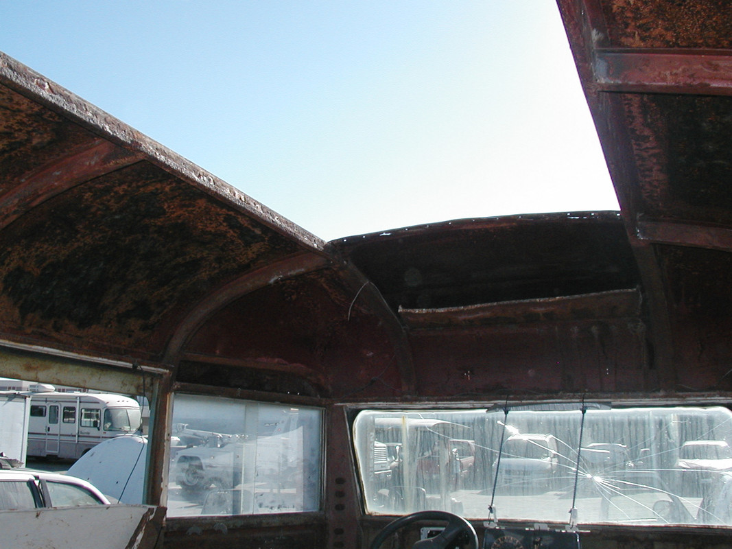

Nothing new under the sun. Don't get me wrong, the Crowns are elegant representatives of bus manufacturing and worthy of their praises. I discovered when I removed the inverted cookie pan center section of the roof on my 1935 Superior skoolie that it has a similar water diverting system to that on a Crown. The cookie pan rested in an upward facing channel with drain holes at each body side rib as well as a trough across the front which carried water out the bottom of the body. You'll see some surface rust in the picture but for having spent its first 75 years in northern Utah the drain system worked pretty well.
