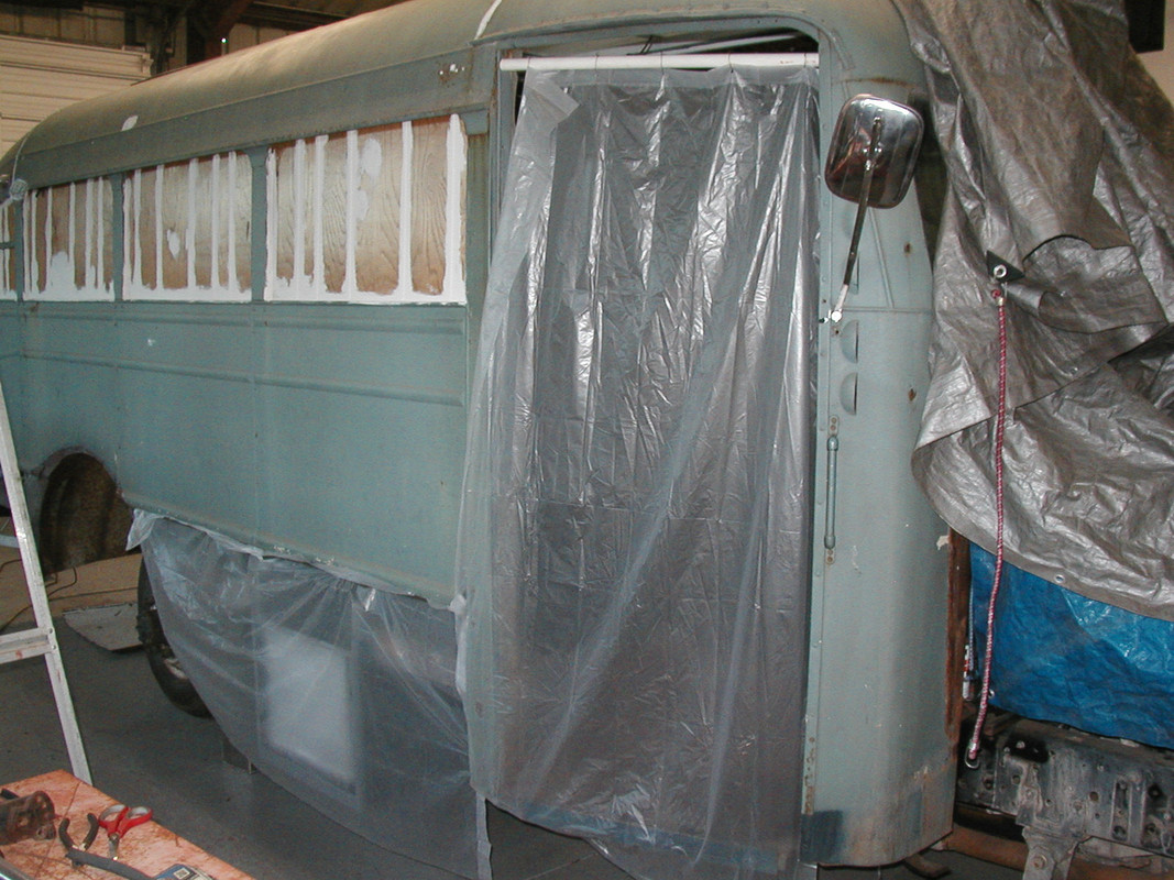

We used DuraPlate to cover our windows (google it). You see it every day and don't even think about it. It is what the sides of all Wabash National semi trailers are made of. It is simply plastic sandwiched between two thin sheets of steel. It is crazy strong.
I wanted some to rebuild my storage area so I called around last week to some semi fleet service places. 360 Fleet Services near me gave me for free 12 sections of semi walls that are 8'x8'.

You read my mind! I am totally going to contact 360 F.S. when I get ready to reskin the Tin Winnie! Last time I was over there on business I casually asked and that's exactly what the guy said, use Wabash DuraPlate. Every time they mod or salvage a trailer there's probably tons of reusable sheet metal and that's probably the least reusable thing for them except for the occasional patch job. Don't ask me why but they had whole 20 foot sections of trailer just sitting there where they'd shortened 53' to I guess 33' because I guess if you need a shorter trailer and you have unused longer trailers the mod is still cheaper than buying new 33s!

Places are happy to get rid of used Duraplate. It can't be recycled so it has to be cut up and hauled away to a landfill.
