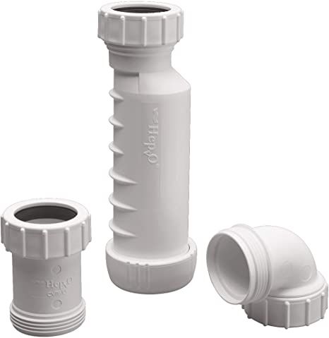

I would never use a "P" Trap in a bus. They require water in the lower loop to prevent the smell from entering the cabin. Park for one week and that water evaporates and when you return to your bus after a month of sitting in the 100* sun you will be greeted with a stench you won't like. The piece you want is called a Hepvo valve. It has rubber flaps that allow one way direction of waste, but closes when no draining to prevent the odor escape.
https://www.amazon.com/HEPVO-BV1BUB1...95483991&psc=1
I’ve left mine for a month in a really hot place. Some water evaporated from the toilet bowl, maybe half. But it didn’t get to the point of smelling.
