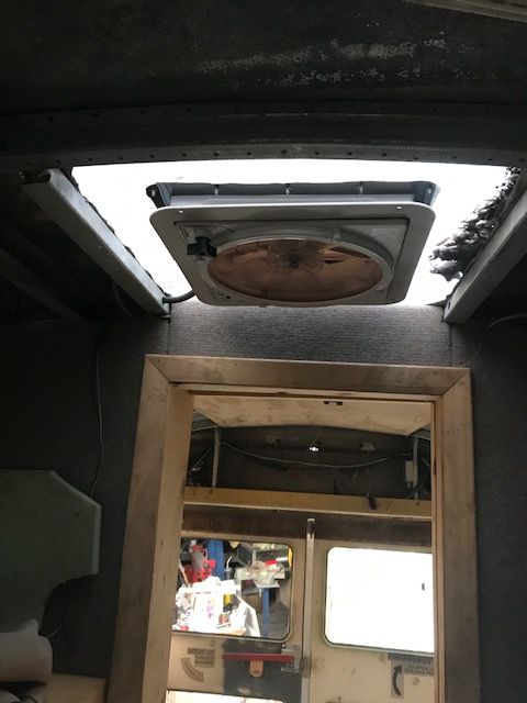

I installed my MaxxAir into the old hatch and love how it turned out. It still bumps up a few inches for ventilation and it opens fully to access the rood deck. Here are a few pics.
cushionhead is offline   Reply With Quote
Old 04-11-2021, 06:35 AM   #19
Posts: 6,451
This looks great, nice job.
