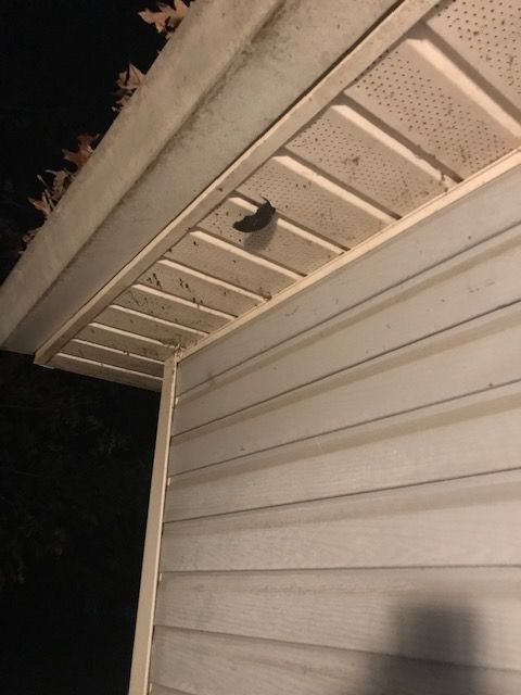

Guards are not foolproof. They won't keep particles out of your eyes. If using one without a guard, have more respect for the tool. Some jobs can't be done with the guard in place.
Here's half a cut off wheel that broke and got stuck in the soffit of the house.
Layers!! alas why there are face shields.. and some even wear safety glasses and face shields.. I doubt a face shield alone would stop a broken cut off wheel like Marc's..

And that, ladies and gentlemen, is why you don't put body parts in line with the plane of a grinding disk, cut off wheel, saw blade, etc.
I wear leather gloves and stay out of the rotational plane when working with grinders.
