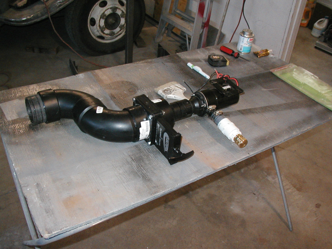

I expect the reason for hook ups being on the drivers side is to help prevent people from backing over the service connections while parking. I have 3 holding tanks ( 2 grey and one black) on my little bus--one of which requires a lift pump to drain into the other grey tank. My holding tanks were all "free to me" so I worked with what I had. This left me with the final drain outlet on the passenger side. I went with a macerator pump and a 5/8" dedicated garden hose so dumping is never a problem and hook up and clean up take only a few seconds.
