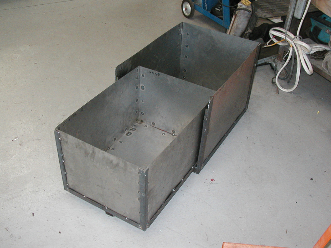

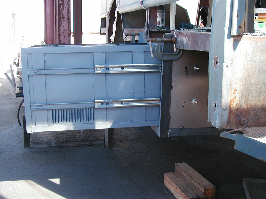

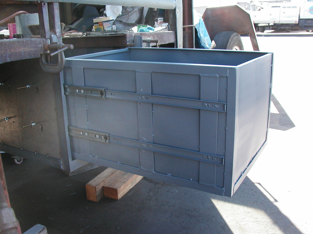

I think you've about covered the pros and cons. The slide out drawer will need to be VERY stout because when extended it will present a tremendous lever arm on the slides but it could be done. The rest of the project will be easy peasy by comparison.
As to placing the genny on the side of the bus, I hung a box with a slide out drawer from the steel floor of the bus rather than from the frame. Jack
