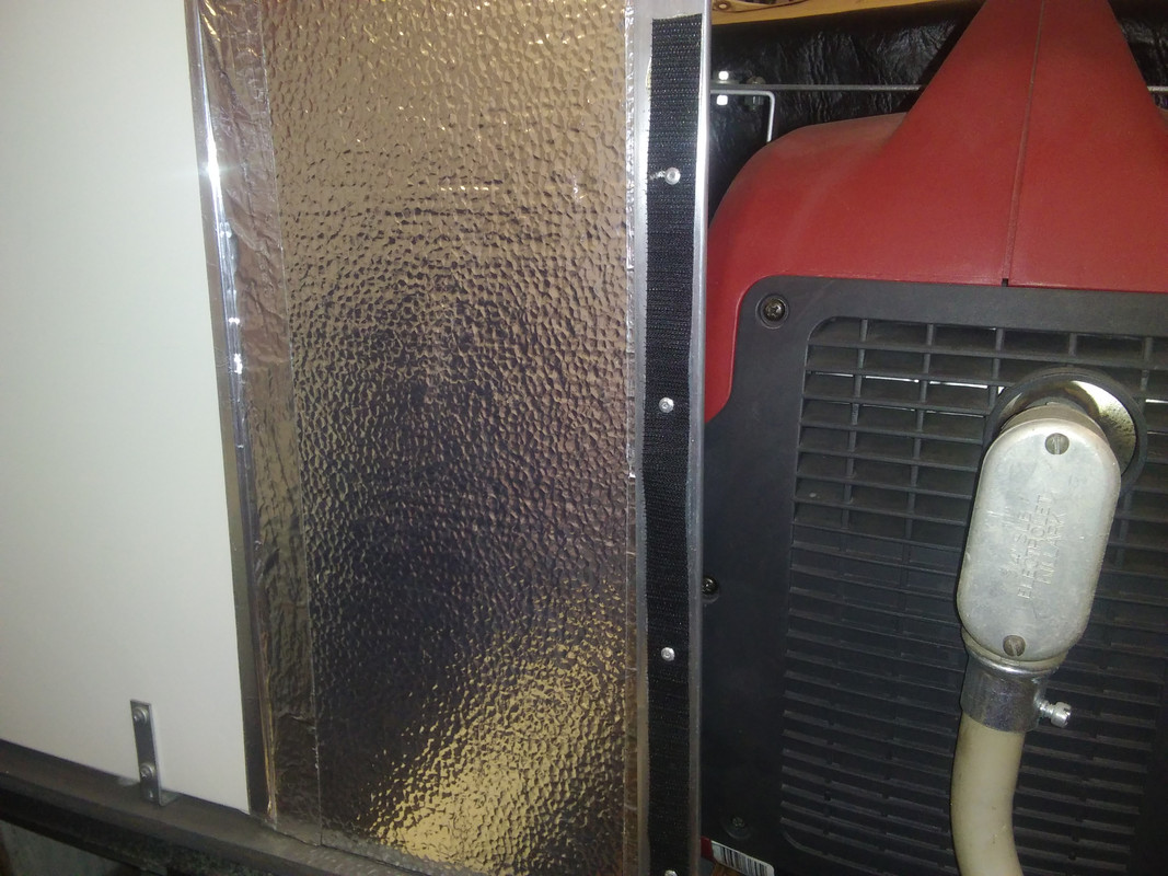

Sticky back velcro doesn't work too good. The velcro itself is far stronger than the sticky and pulls it off the surface. It is OK as long as you don't plan repeated attachments and removals. I'll add that the sticky is weakened by heat--like sun shine. I've found pop riveting the sticky back velcro helps but it looks sort of wonky.
I used sticky back velcro to secure part of the cover over the genny and frig on the tent trailer I tow behind my toad (when it isn't a toad) The warmth of the sunlight was enough to loosen the glue.
