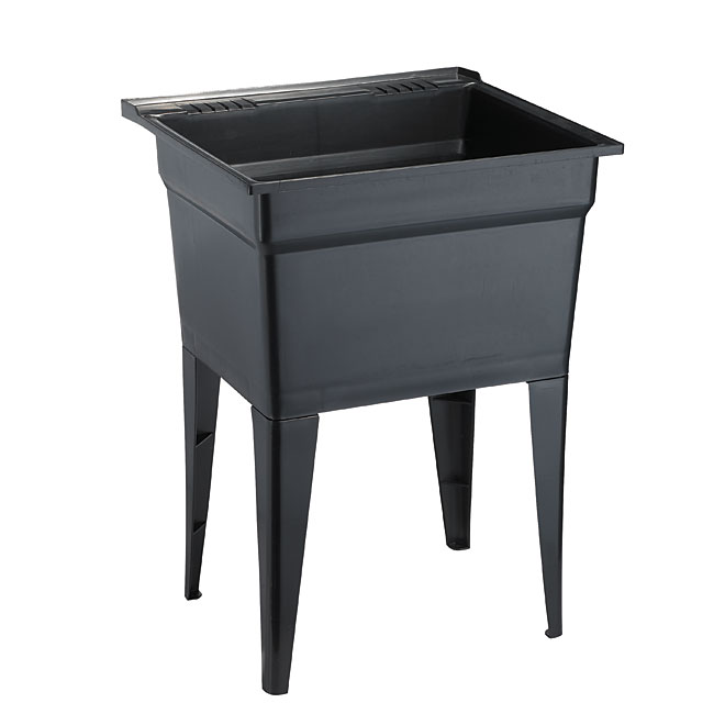

One route I've been thinking is to use a laundry tub as a pan by cutting down the sides and spray foaming the underside to add rigidity, but that might prove to be a bit too small. 24"x22" seems to be a fairly standard size for laundry tubs.

We used a utility sink. It's small and we don't know how durable it will be, but we've both showered in it without issue and is Drew 6'1".
