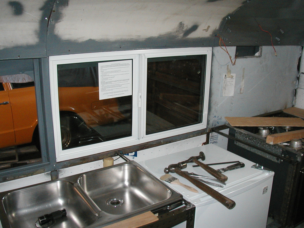

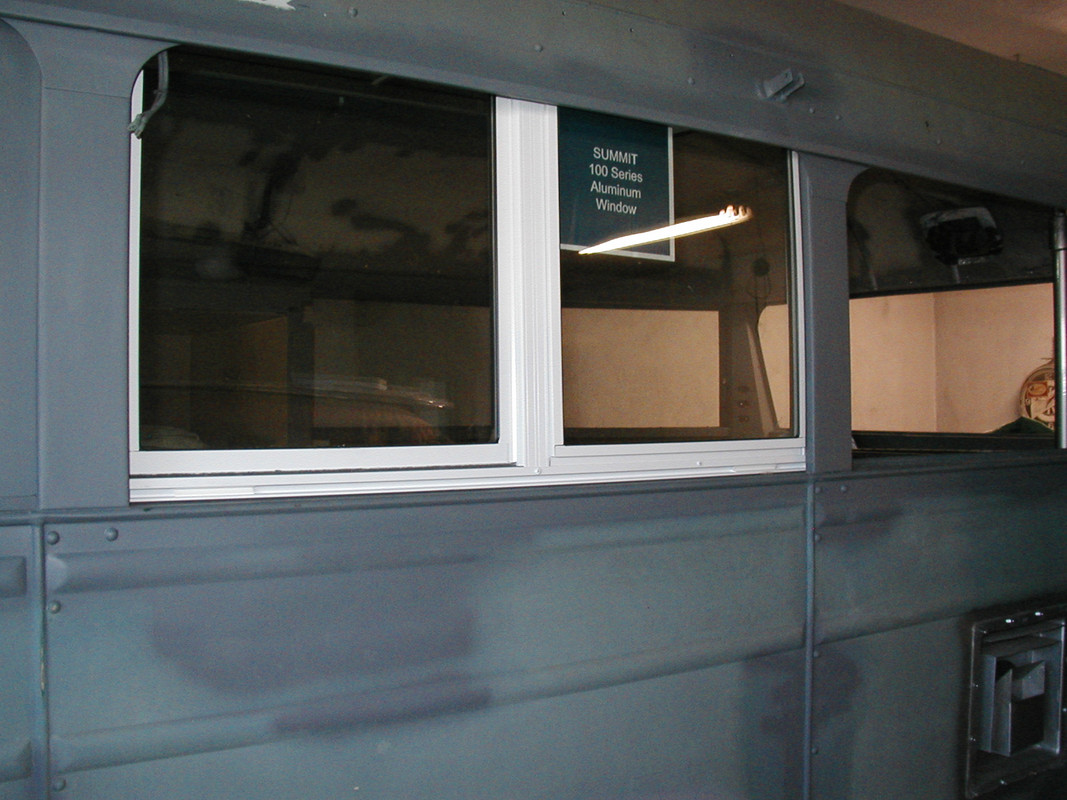

Joe45, I used residential windows in my bus and have been happy with them for 5 years now. Since you can't use aluminum framed windows in residences here in Kalifoprnia any more they had to be special ordered as "shed" windows. While I was ordering I had them use dual glazed "double strength" glass, temper it and apply E coat to help with the heat. I chose horizontal slides and removable screens. The window cases screw into the original steel window openings and I sealed them around the edges with Silkaflex 220+ urethane windshield adhesive (cleans and smooths with mineral spirits but can make a mess and is paintable).
