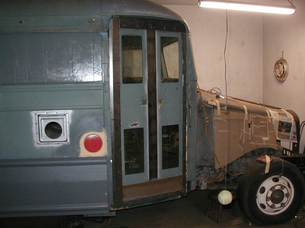

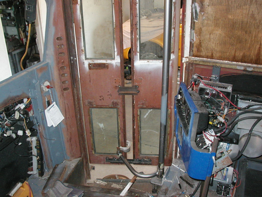

Like several other Skoolies I wanted to keep the school bus look and to be able to see through the top and bottom of the door. The front half of the original two piece door folded out and the rear door folded in blocking the space where I wanted to put the genny and house electric controls. I ended up buying the innards of a "parallelogram plug" door from a shuttle bus, welding my original doors together and mounting them on the new hardware.

Posts: 3,236
Thanks. The door is one of my favorite toys.
Old 06-10-2019, 05:41 PM   #31
Posts: 2,447
That cardboard painted up nicely!
Old 06-10-2019, 06:36 PM   #32
Posts: 3,236
LMAO! Sometimes the mock up is good enough to just paint and keep.
