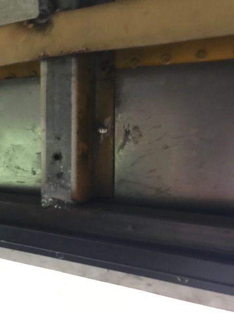

05-11-2021, 05:51 PM
Originally Posted by aswallie
Oh! That's a very good point that I hadn't thought about. Right now I'm looking to get my hands on the material and haven't finalized exactly how I want to do the raise but I'll definitely take this into mind when I do it. What's the best way to build the window frames if you cut at the windows?
I misspoke, if you raise 14", you will need sheet metal 44" wide, it's 30" from roof to bottom of windows with a 2" overlap. So you would need it 14" wider. Once you have the roof raise determine where your windows will go and weld upper and lower horizontal bars between the ribs and then add bars on each side. Then reskin the outside, cut out your window holes and mount the windows.
