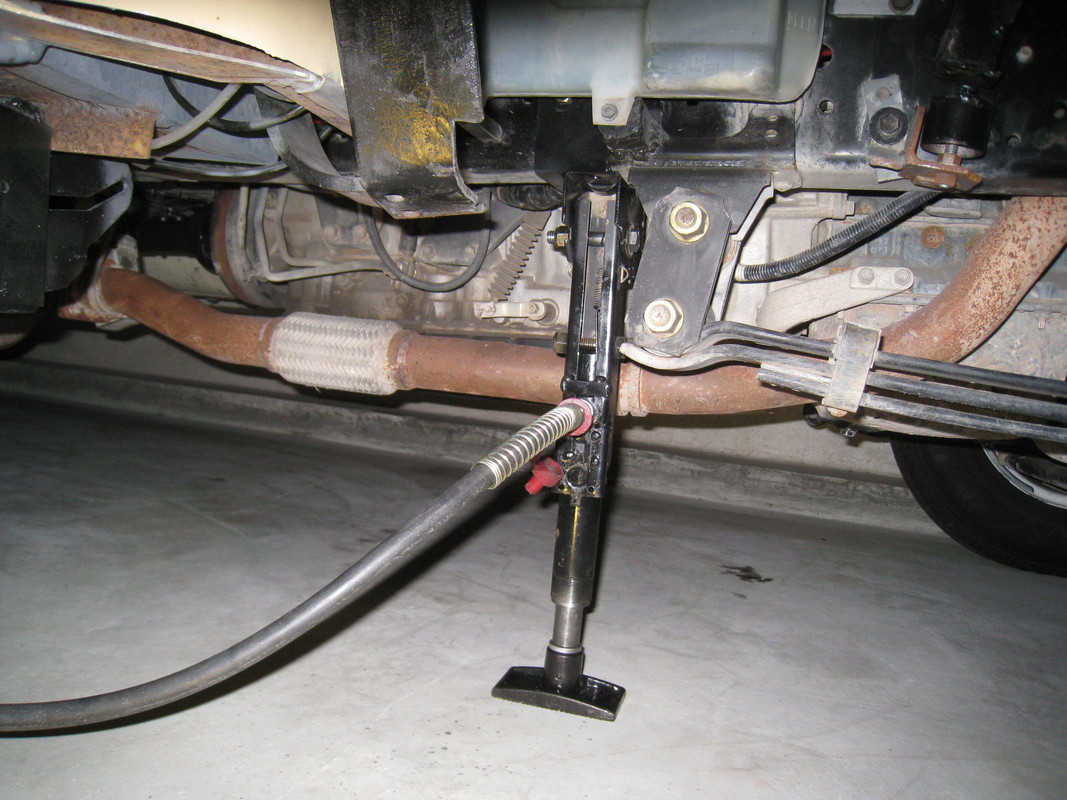

I built an inexpensive (about $150) leveling system the hydraulic pump from a Port-O-Power automotive body tool, four 10" rams. four tent trailer jacks, a gang valve and some steel and flex hydraulic lines. All the parts except the valves and lines were Craig's List finds.
