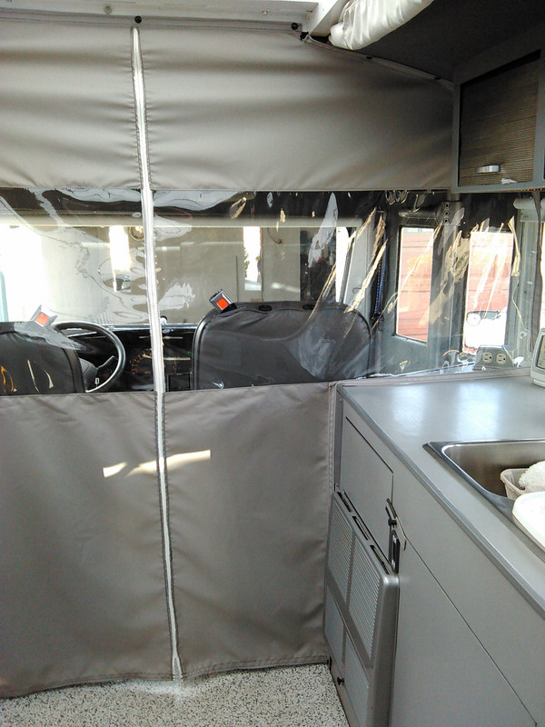

I like to post pics of whatever I have just been palavering about and although the lino can be seen in the following pic, the pic was originally taken to show the zippered partition I use to isolate the down- the- road AC from the rest of the bus when we are driving.
Okay Jack .... who, what, when, where on the divider! We really need to do this sort of thing in our bus!

Pardon the thread drift but to answer your question Native, the grey material is light weight awning material and the clear is upholstery vinyl like you find covering the silk chair cushions in a not so fancy Chinese restaurant. The center zipper is plastic and zips up from the bottom for access to the back of the bus. You can see at the top of the pic some of the black snaps that hold the divider in. Installation and removal takes about a minute.

I assume that was done to provide heating/ cooling of the driver compartment only while driving -- do you find it makes the driver compartment any quieter when you seal it off from the rest of the bus?

David, just for heating and cooling down the road. The partition probably would help lower the noise in a rear engine bus but in my little diesel front engine thrasher nothing but the ignition key much helps with the noise.
