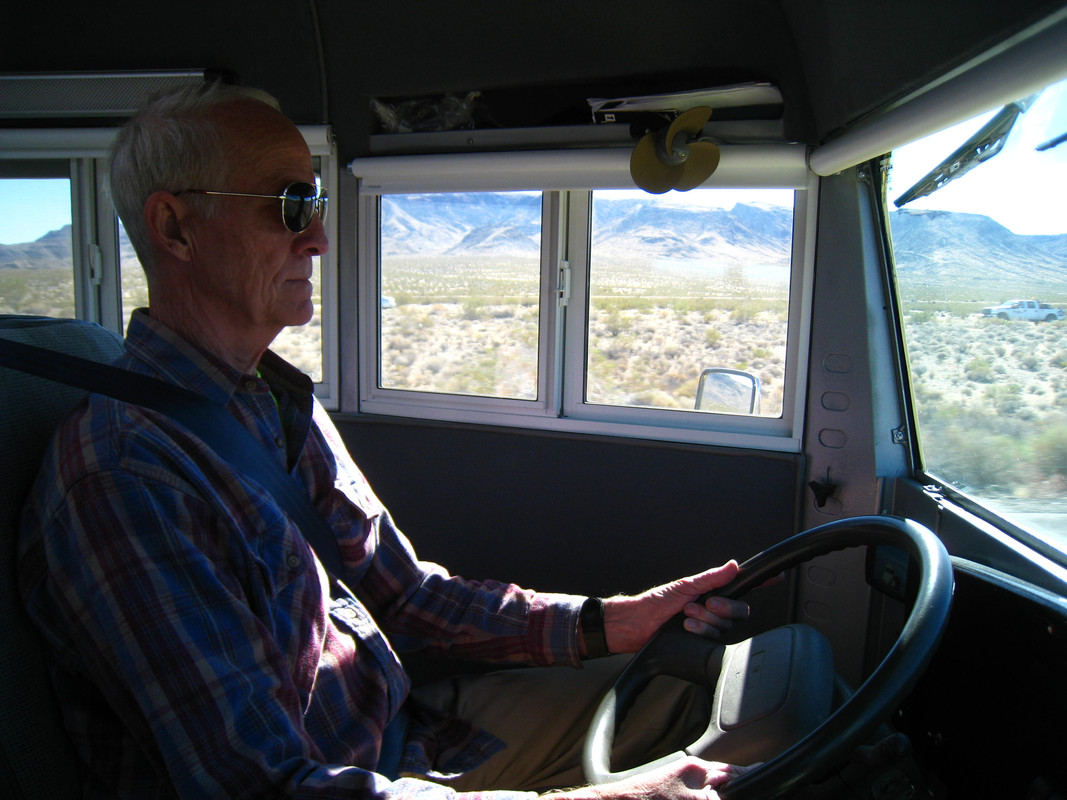

My bus was built with neither a heater nor a defroster. I added a small heater but still have no true defroster. I did put in an old school rubber bladed fan which blows across the windshield with enough force to keep the inside glass clear but sure wouldn't help much with frost on the outside.
Since you do have a defroster of sorts maybe a little fan like mine would help spread the heat around.
04-30-2020, 11:26 AM
Posts: 23,764
YOu should post more pics Jack. You and that bus are quite photogenic.

Currently, our bus has no heater installed. Yes, we have a ceramic electric heater in the cab area, but it is only a chill chaser. To solve the defrost(anti-fog) situation, we added a fan mounted at the top left corner pointed to blow across the widshield. It works well for all but about 1/3 of the passenger windshield. So, adding a fan like Ol Trunt has will help.

The bus came with 2 fans already mounted up there like trunks. On my test drive the other day, it seemed the defroster blew a lot of air, but I won’t know until some crazy storm- at the worst time. Good thing about this whole deal is that I’ll just pull over and ride it out.
