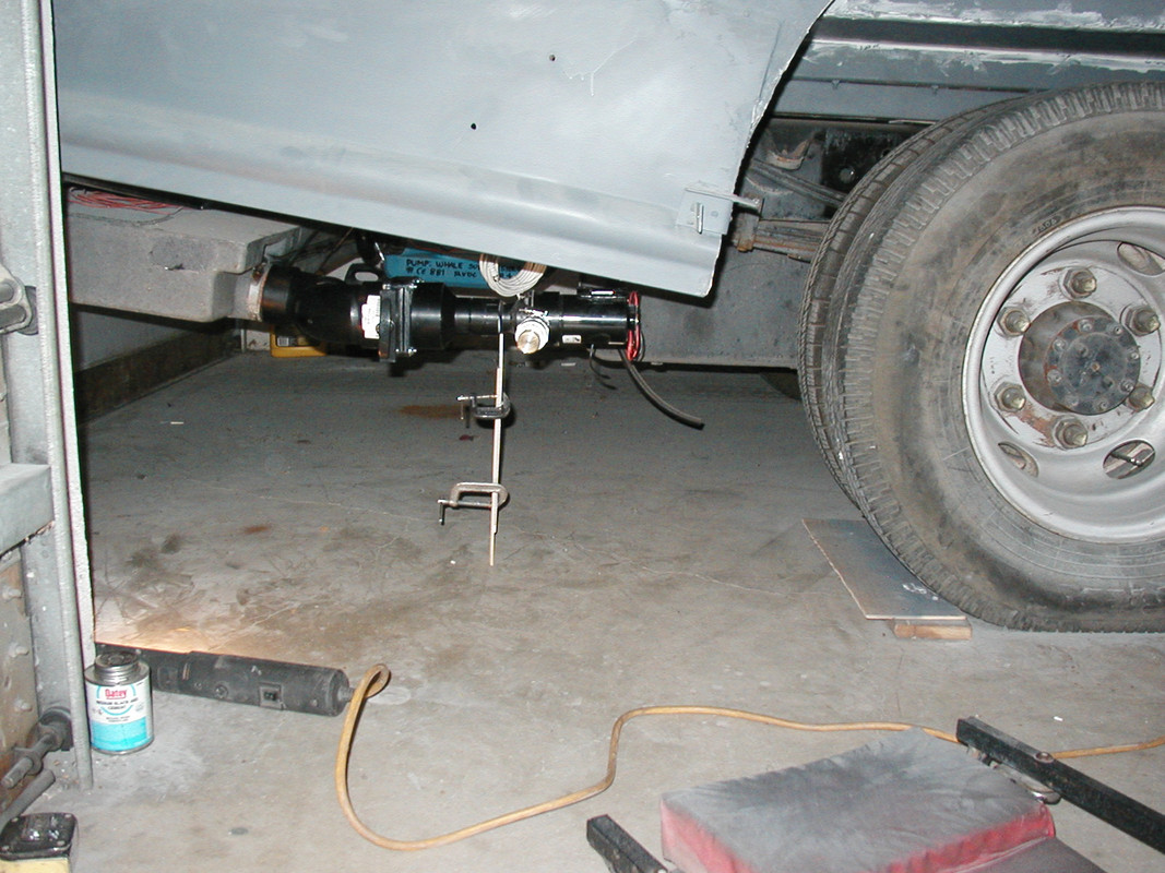

My layout is much like you propose in that the shower and it's separate 7 gal grey tank and the 27 gal black tank are all behind the axle centered between the frame rails. I've never had a problem with the tanks catching on anything but I am careful about entering steep drive aprains at an angle to allow one set of tandems to help boost the tanks upward as soon as possible.
My water inlet is on the drivers side but the electric hookup and tank discharge are on the passenger side. Rather than use a stinky slinky I installed a macerator and use a 5/8" garden hose to drain the tanks. The garden hose is much easier to clean out and store than the nasty slinky and makes worrying about where to park a non issue.
