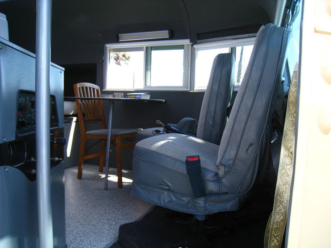

Here's the seats I put in my bus. They were from a GM minivan. I extended the legs. I remove the drivers seat when camping and our kitchen counter extends to the windshield.

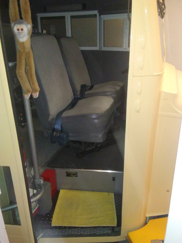

Alternate seating solution
I saved 2 original seats and installed them side ways at the front, installed seat belts, and also use for dining.
03-22-2020, 08:40 AM
#71
Posts: 7,000
Is your family just tall and short people?

Some really clever ways to do a jump seat. I particularly like RolesvilleMarina's mechanism that folds into the dash.
I put my jump seat on motorized tracks (Ford Crown Vic power seat rails). The tracks run at an angle that moves the seat forward and back and towards the entry or towards the dash center The seats are from a Starcraft motorhome and have 3 point seat belts and swivel built in.

03-22-2020, 11:22 PM
#74
Join Date: Dec 2019
Location: Midland, TX
Posts: 4
Chassis: Transit
Engine: 8.2 Detroit Diesel
Rated Cap: 44 + driver
We are average size. Maybe it would be not comfortable for a large person.
