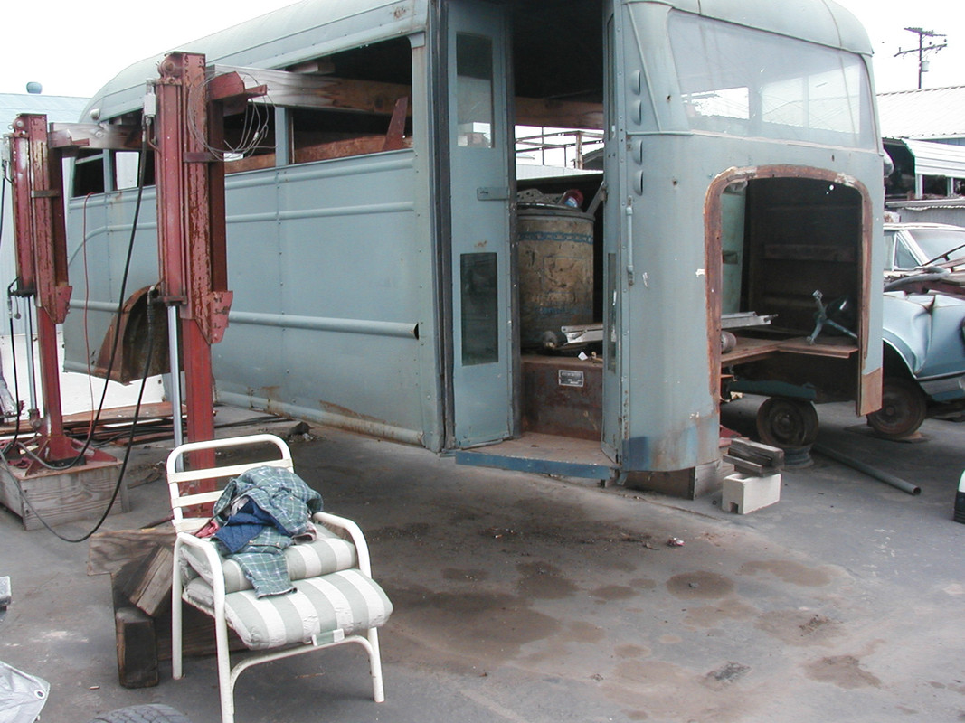

Posts: 3,200
This is how I did it.

A picture is worth a thousand words ... There's two thousand right there!
Yeah, the underside frame mounts shouldn't be too bad, the firewall might be time consuming, it's all the wiring and plumbing that'll break your heart! Knowing that when manufactured the body is married to the frame but all the connections between them are simply coiled up and waiting, now you have to find them, disconnect them, and either recoil or remove entirely all that wiring as well as a few plumbing lines. Then it's a matter of having heavy duty enough equipment to lift the body which even sans seats is going to be several tons more than an average car or SUV so no thinking a couple of jacks is all it'll take.
One question, in regards to the driveable frame, just to clarify, are you looking for a way to drive it/use it while the body is off? Or just cover it for the time while it's exposed? The latter is easy enough but if the former I'm inclined to agree with fo4imtippin to just go with a box truck. Actually less work to disconnect the box and if necessary cut the back of the cab for passthrough access.
