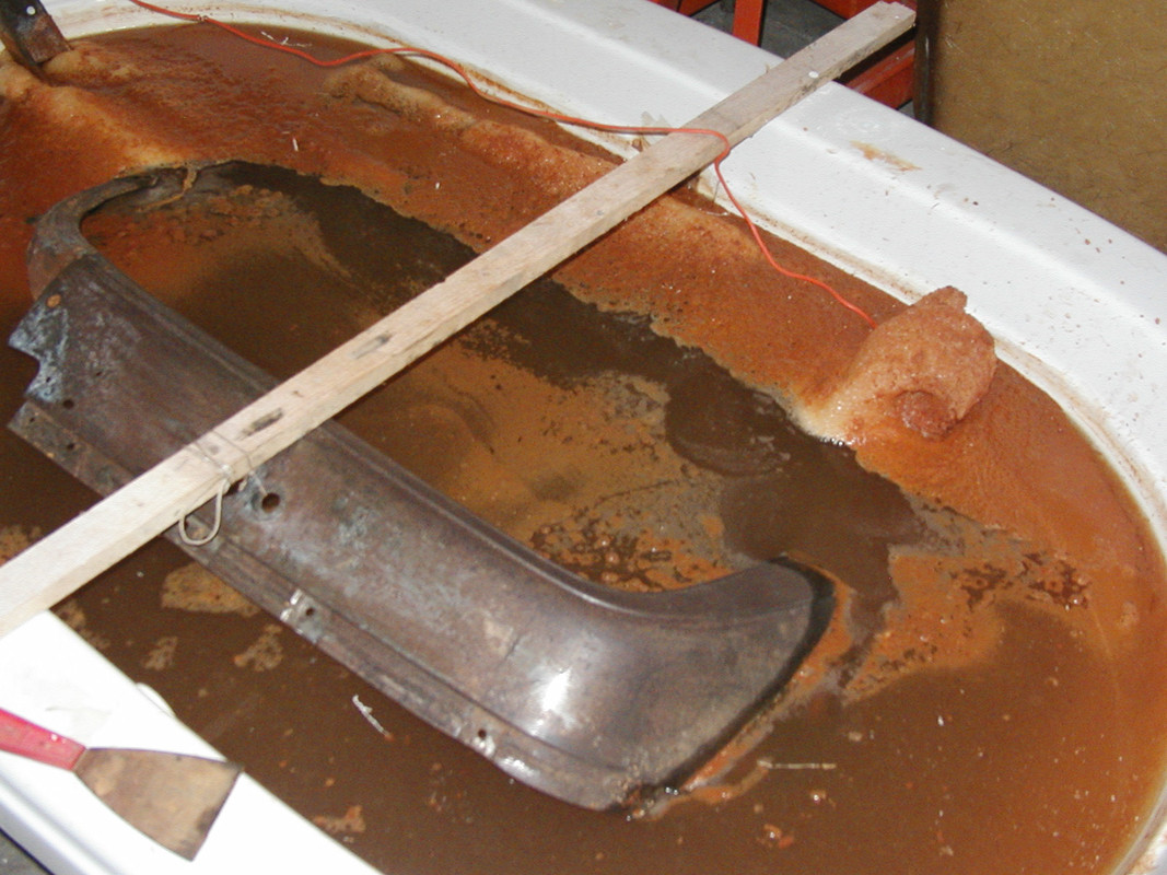

What worked PERFECT fore me was electrolytic rust removal--of course you have to remove the parts so you can dip them but if you happened to have a swimming pool to dip the entire nus in you'd have it made!

That's some nasty looking business in that tub!

Native, its baking soda and water. Once it really gets going it begins to look like a big batch of chili with beans! When the power is turned off and the water is allowed to sit the "rust" drops out of suspension and the water becomes clear again. The water can be evaporated and the sediment once dry goes right to the land fill.
Ah yes baking sode and water make a great buffer solution.
What was the % or baking soda to water (i.e. the recipe)?
I see in the photo there is one wire. Where is it attached?
Where is the second wire attched?
How much current and at what voltage?
Care to write up an "Electrolysis 101" thread?
