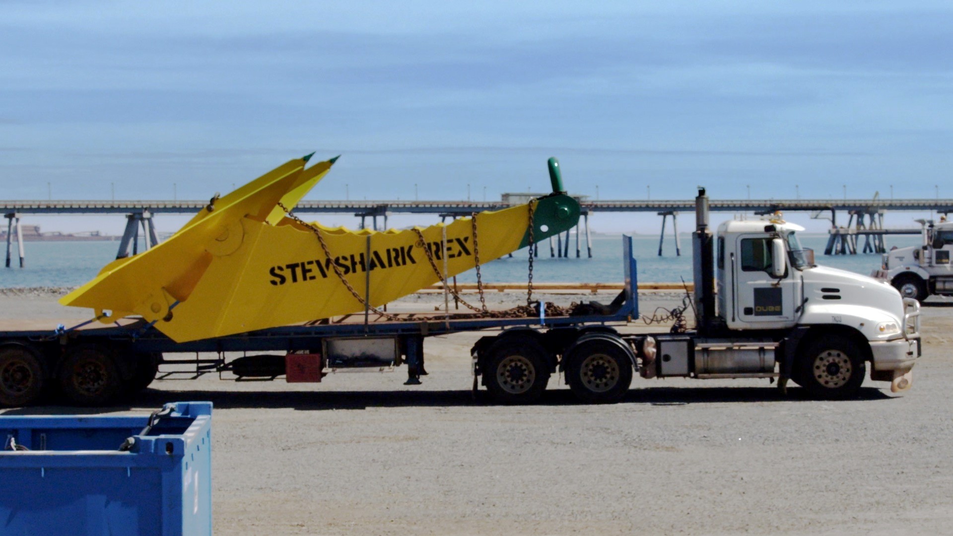

This is my office every day. heavy trucks, steep mountains and the sh*ttiest conditions. This is the Coq (Highway Thru Hell) I know what works for me and it works for everyone else if applied right. Im not here to debate this any further but a big beef I have is your very first response to the OP was not accurate but stated like you knew the answer, only later revealing that in fact you are not a commercial operator and have little experience in this matter. This does a great disservice to the new members and new drivers and is dangerous. How about next time start your response with
"hey I'm not a commercial driver and don't have an air brake endorsement but my opinion is"
Stay safe
Oscar
