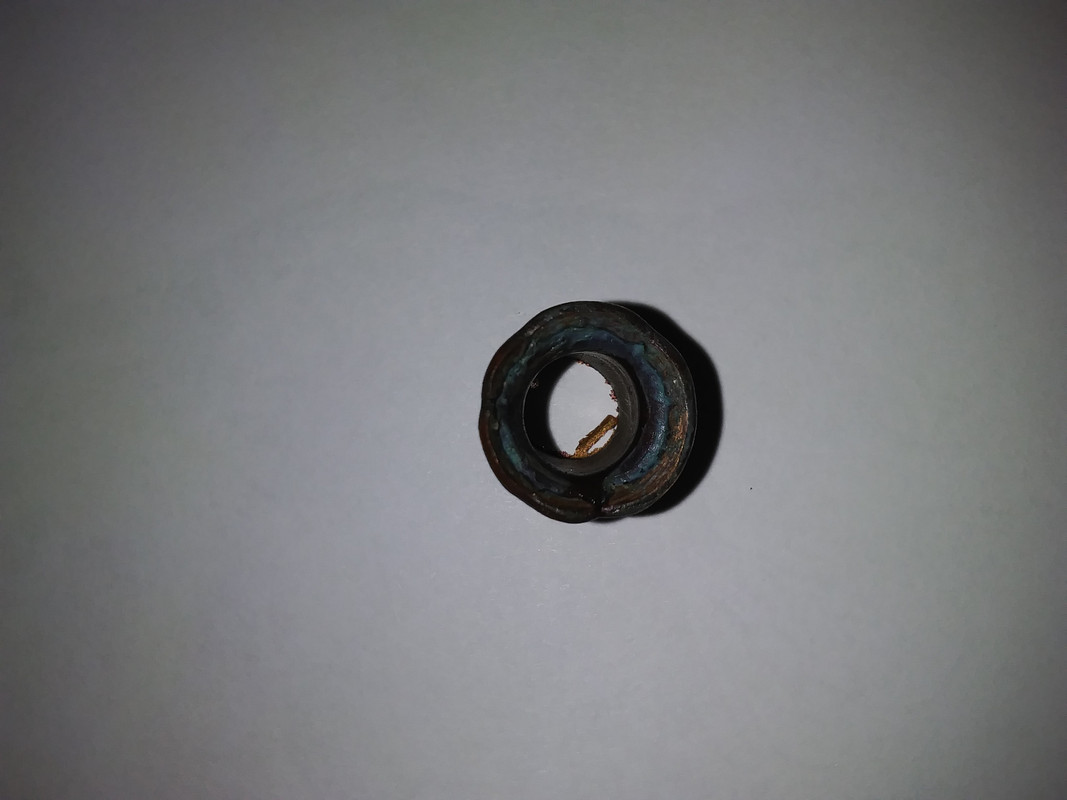

6 PM here and I finally made it to the bar. At home. I spent the weekend locating and repairing a very small propane leak. Neither of my propane sniffers thought it bad enough to start squalling--but I could smell it. After pulling out an entire side's worth of upholstering, draining and raising my 60 gallon fresh water tank I finally found the leak. It was in one of the original donors connections in the low pressure side of the propane system. It didn't leak when I installed it so I left it alone. I should have checked more closely. The leak was the result of the worst attempt at a double flare I have ever seen. No wonder it leaked. Jack

Dang Jack! You might hire yourself out as a "sniffer"! Kinda "alarming" the tech gizmo couldn't find anything. Sorry you had to dig so deep to find but really glad you did.
I just hate it when RV's explode.
