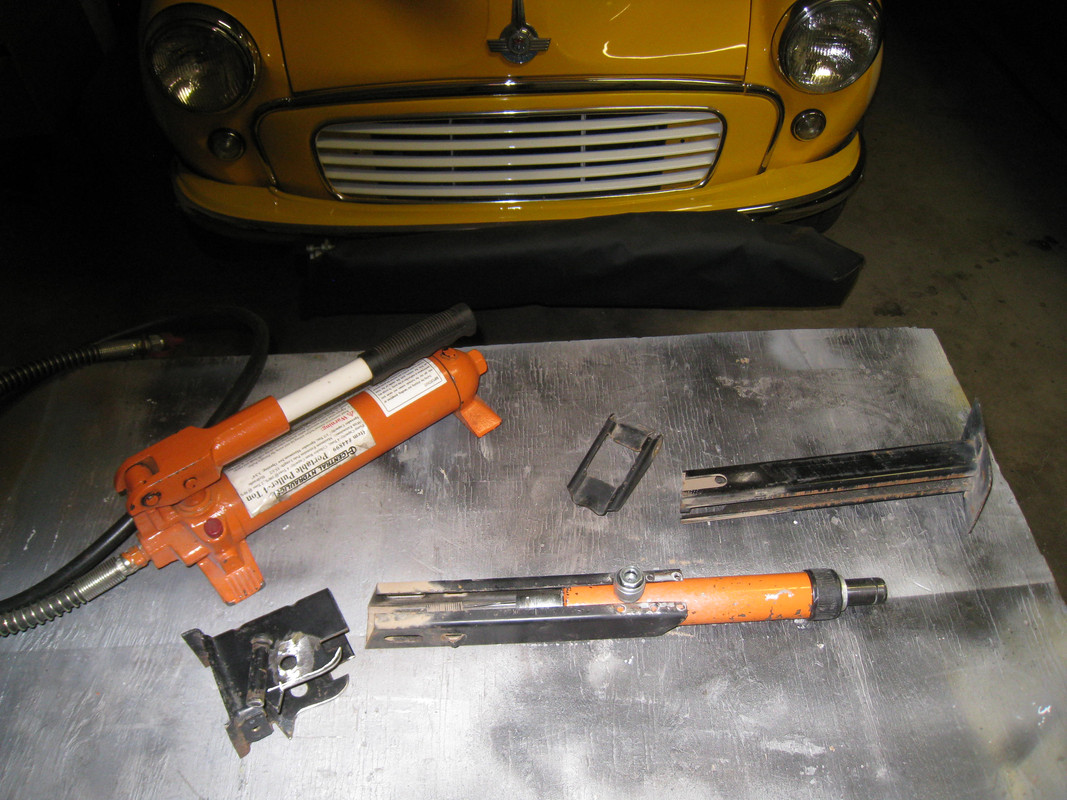

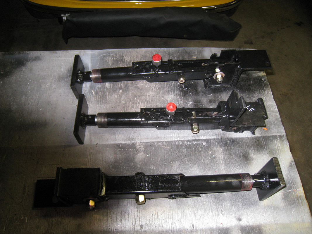

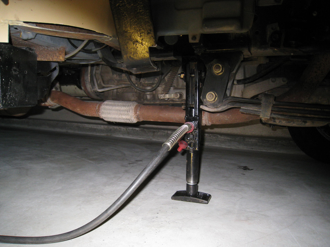

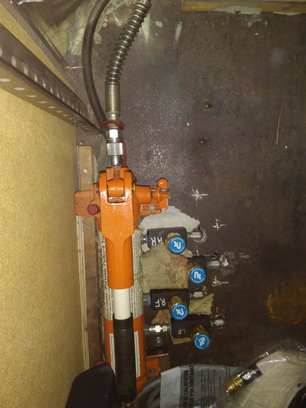

I pulled 4 tent trailer spring latch stablizing jacks from a dead trailer, substituted hydraulic rams for the jacking portion, and plumbed them to a hand operated "Port-A-Power" pump via a 4 gang valve. About $100 in parts and materials

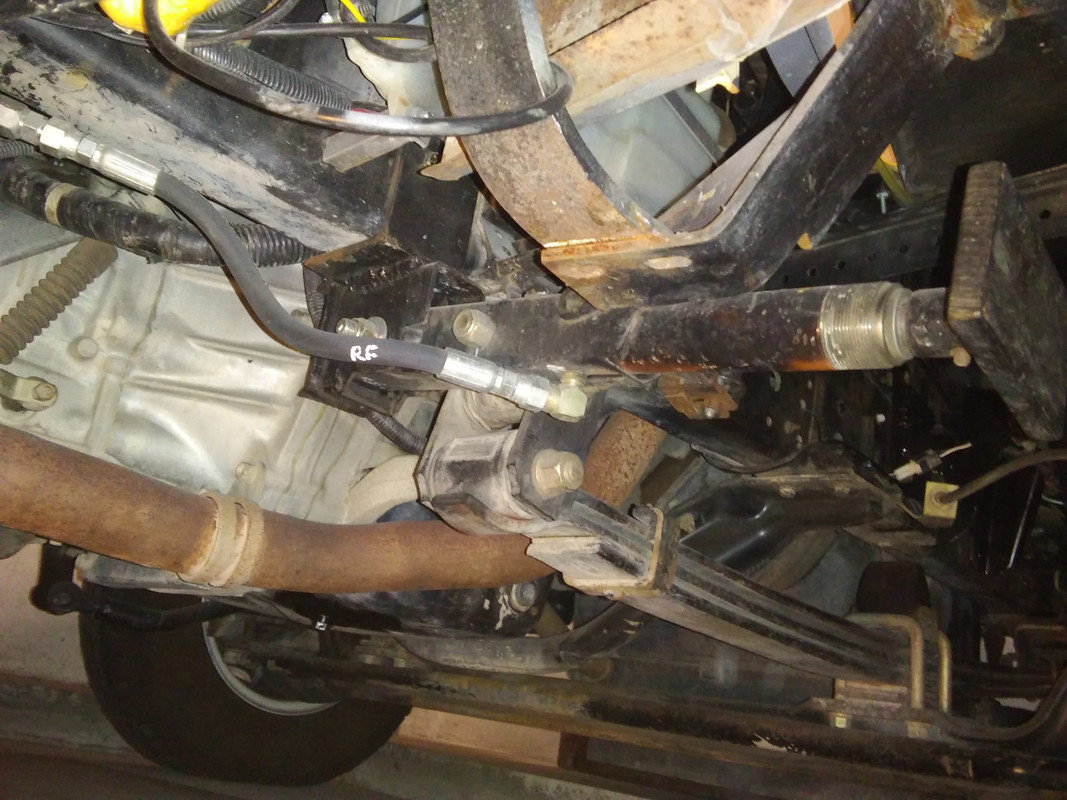

The hydraulic line in this pic does not lay on the ground in the final installation but connects to the steel lines from the pump.
