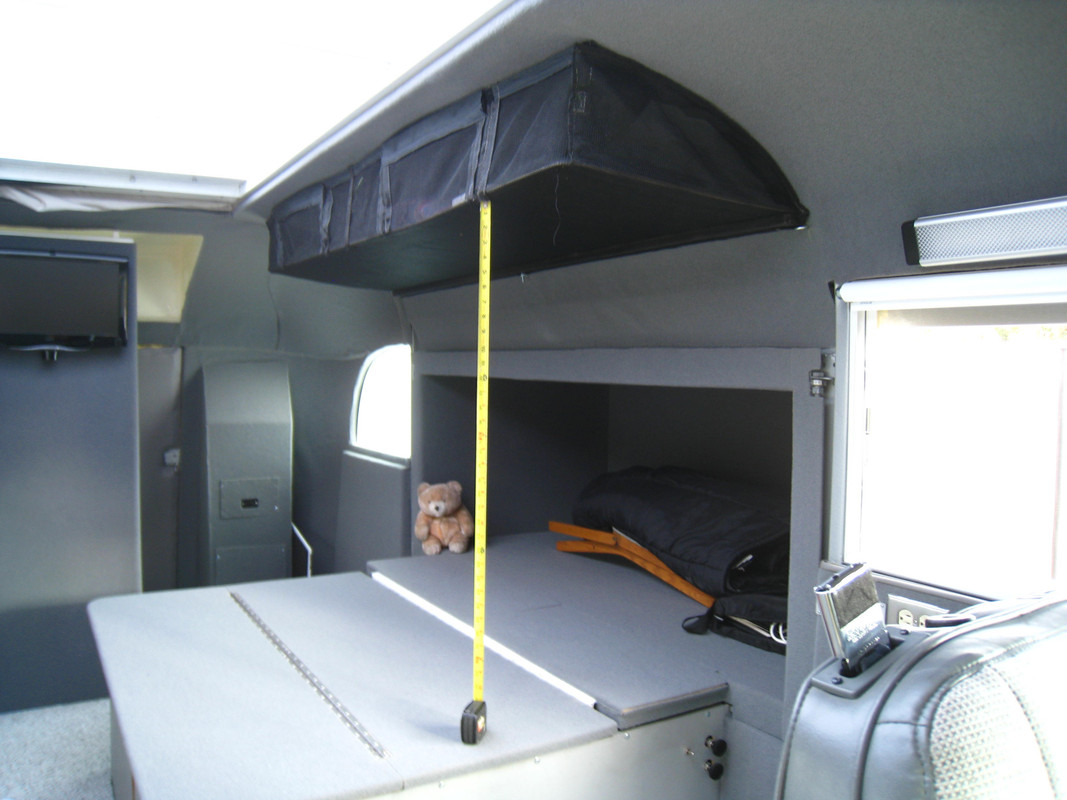

Overhead shelf up front:
But space and organization are SO important in this thing overall. My project last Sunday was to get a shelf up over the sofa as a much-needed catch-all up front. The downfall of convertible furniture is that you can't put stuff on it and keep it there -- nighttime comes and you want to crash, and you realize you have all this junk spread out all over the table. So I want to keep the front uncluttered, all the time.
I didn't reinvent the wheel here or do anything that clever -- just basically ripped off the thing I've seen lots of people do on this website. I screwed some 2x2s into the ceiling and made a basic frame, jigsawed some plywood for the ends, cut a piece of ply for the bottom, and voila, a shelf. I have some trim that still needs to go around the front, but I feel like it's a pretty decent light-duty storage area. Yep, I just threw it right up there, overlapping the front headliner, because I don't really care, and I kind of like having that headliner up there; I just notched the 2x2 so it would go over the metal trim piece and still lie flush on the ceiling:

THIS is exactly why I would never buy a pre-built RV. You're taking the needs, interests, and aesthetics of your family and brainstorming a really creative, evolving layout! That's what the skoolie thing is all about.

Personally, I wouldn't rely on a lip to keep the books in place. I am a big fan of DOORS on upper cabinets, a predilection I developed while driving cross country in Buster. Some of the best places to go have some of the worst roads leading to them, and lots of items, books in particular, have an interesting ability to jump over lips and end up flying. Even some sort of netting would work, but my own experience has been that there isn't a lip high enough to guarantee things stay where I put them.
Yeah. The lip was a total failure. I haven't really solved it. And you're right about a door being the best solution. I'm going to try other things, though, because I like the idea of the bookshelf being visible. I value the stories in the books up there, and I feel like if they're visible, we're more likely to read them, and to be conscious of them surrounding us. So it's kind of a values thing.
One of my other closely-held values, though, is avoiding getting hit in the head with books. I've been thinking about doing something with a bungee cord that makes it look less like a bungee cord, but it's a pretty half-baked idea. Maybe in the end I'll do a cabinet door with a big window in it...depends on what kinds of materials come my way.
How about cargo netting, or some kind of screen material, attached to a door frame?
Ah yeah, that's a pretty good idea -- over in Don's Busted Flush thread, I think he mentioned he was going to use some kind of wire mesh in frames for some of his cabinet doors!
My mind immediately goes to the roll of chicken wire I've had in the "materials" pile forever, and I think it could either be awesome, or it could look like some kind of Joanna Gaines-influenced nightmare. Might try it and see.

I used "roll front desk" type doors on the cupboards over the sink and nylon mesh with zippers and Velcro and a pliable tag board bottom for my linen closet above the bed--it all gives when I accidentally stand (sit) up under it.

I really like the idea of the 'suitcase' overhead cupboard - that should save some bruising - lol - clever roll up doors as well
Wow, Jack, those roll-front cabinets look great, and I've never seen a soft-side cabinet like that anywhere else. Such cool ideas!
Those roll front doors are really nice, Jack. Early on in my design process i thought of using those, but they were about 4 times more than I wanted to spend. Then, I researched making my own, and they were about 3 times more than I wanted to spend.

Those slat roll doors are called tambour doors. Nice to know my years as an antique dealer taught me something.
