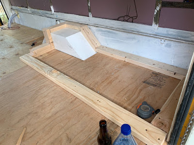

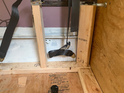

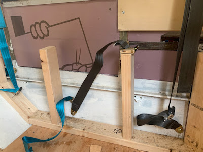

How to Install Seats in a Skoolie
Where Should Seats go in a Skoolie?
There are two types of seats you should be thinking about: where passengers will sit while driving, and where guests will sit while seating. The passenger seats require installation where you can install seat belts (see my previous post about that), while the guest seats can really go anywhere. The passenger seats should also be secured in such a way that they won't fly around in the event of a crash (see my previous post about installing the floor for more about that).
Now here's something I didn't consider when I installed the seats, and only realized after our first trip. The back of the bus is the least stable, meaning it bounces a hell of a lot over every single bump in the road. Unfortunately it's too late for us to flip the layout design so that the passenger seats are in the front, but if I had to go back and do it again, I'd probably put the passenger seats right behind the driver's seat for passenger comfort, as opposed to all the way in the back. Oh well, maybe my next conversion will be oriented properly.
How to Properly Size Seats in a Skoolie
If they're too high, it'll be uncomfortable because your legs will be dangling over the edge without touching the floor. If they're too deep, the edge will dig into your calves. This isn't anything new, and there's a ton of information and guidelines out there, so let's compile it all for our purposes here.
Here's a summary of what Cornell's Human Factors and Ergonomics Research Group has to say about it:
  • Seat Height: about 17" (with a minimum of 15")
  • Seat Depth: 16.5"
  • Seat Width: 20-22" (this isn't really a factor for bench type seating)
  • Seat Angle: 5-10 degrees, meaning the forward edge of the seat (located under your knees) is higher than the back edge, giving an angle between 5 to 10 degrees. As an example, if we use the ideal seat depth of 16.5", the forward edge under your knees would be 1.43-2.85" higher than the back edge.
  • Cushion Height: 1.5-2"
    • Overall, the cushion should be more firm instead of soft
    • Ideally, the top layer should be softer, and the bottom layer should be firmer
    • The soft layer compresses to 25% it's normal height, and the firm layer compresses to 65% it's normal height (remember this for later
    • The ideal ration of soft cushion to firm cushion is 2.6--meaning 2.6 inches of soft cushion for every 1 inch of firm cushion, which if we used those exact numbers means we'd have a cushion 3.6" thick total. If we went with a 4 inch thick cushion, the top softer cushion would be 2.88 inches thick, and the bottom firmer cushion would be 1.11 inches thick
  • Armrests should be 8-10" above the seat surface
  • Backrests have three levels of support
    • The lower, lumbar support should be 5-9" high, with a concave curve depth of .6-2" into your back to support your lumbar region
    • If using a middle sized backrest, the height should be 26"
    • If going for the full neck and head support, the height should be 36"
    • The angle backwards should be between 100-110 degrees from pure horizontal, meaning if the seat was flat with the earth, go backward 100-110 degrees (not including the Seat Angle mentioned above). In other words, 10-20 degrees backward from the vertical axis.
The above really is for office seating, not skoolie seats. We want something more robust and more comfortable than that, and we might also be using these seats for a bed that we want flat for sleeping. I used the following reference because my plan calls for a table that lowers into a bed, courtesy of Shop4Seats.
  • 4 inch cushions (the following measurements do not include the cushion depths)
  • 15" seat height
  • 20" seat depth
  • 31" back rest height
This is totally flat, however, and I wanted something a bit more. Also one has to account for how much the cushions compress when sitting on them. So even though the plywood is 15 inches high, you're sitting higher than that due to the 4" cushions, but you're not sitting 19" high, because the cushions compress... see what I mean? This can get finicky real fast.
So here's what I did for my seats. It's not the right way, it's just one way, and I still didn't even get it right. I decided to match up with the Shop4Seats dimensions, since that's tailored for RVs instead of office furniture, but I still combined the two to maximize comfort.
I planned on having 4 inch thick cushions (which is no longer valid--my cushions will be closer to 6 inches now that I've ridden around and see how much more I need), so the following measurements are only for the plywood dimensions, excluding any cushion dimensions.
The flat seat height is 14" high, but I installed 2 x 4 inserts to give it the Seat Angle as mentioned above in the Cornell summary, so when sitting with these inserts, the seat height is actually about 15.5" high. With 4 inch cushions, assuming they compress to 50% their height, the actual height of my knees is 17.5" high--right within the ideal range. However, my new plan with the cushions is to get 6 inch thick cushions, using the ideal ratio above, so we can rework the numbers here. If the total depth is 6 inches, the soft top foam should be about 4 inches thick, and the bottom firmer foam should be 2 inches thick. Using the compressibility numbers, these would compress to a total of 2.3" high, meaning the new sitting height would be between 17.5-18" high. This is still acceptable!
The depth is a little odd here. I opted to make the seats exactly 1/3 the width of the bus, meaning they are about 26" deep from the front edge to the wall. However, my partner really did not want to install backrests as they would obstruct most of the bottom panel of the windows, and she determined we could use the following as a backrest.
We originally planned on 4 inch this cushions (now 6 inches thick) for our dinette seating, meaning that when we lowered the table, we'd put the back rest cushions on the table to make a continuous mattress. Putting a sheet on there is kinda awkward, so we are also planning on getting a 1" thick memory foam mattress topper (it just so happens our dinette bed and seating dimensions are appoximately a queen size) to sleep on top of, but when we're not sleeping, this will be rolled up and velcroed tight in a roll against one of the walls. Then we will put the back rest cushions between us and this roll, and, in addition to extra pillows, will form a backrest out of the cushions, pillows, and mattress topper. For the other side, it will just be our head pillows instead of the mattress topper, plus extra pillows and cushions. I personally don't think this will be sufficient, particularly when the bus is moving, but I'm not the one sitting back there... and there's the old adage about a happy wife... so I just let this one slide for now, but I'm fully expecting that we'll still have to install some sort of back rest once she realizes that this is probably the source of her discomfort when riding along back there.
For now, though, that's what we have: 14" high seats, that go to 17.5" high with the 2 x 4 inserts, and an undetermined depth pending properly sized cushions.
How to Frame Seats in a Skoolie
The most common way to frame seats (and everything else) is to use standard common 2 x 4 planks. However, there are better ways to frame than that. Square metal tubing might be the best, but you need to have a welder and know what you're doing with it for this to work. Metal tubing weighs less than a 2 x 4 and is stronger. Another way is to simply use at least 3/4" plywood sheathing for both the wall and the frame, and use the Kreg Jig Pocket Hole system to mount the plywood vertically without the need for a frame. I kind of wish I went with this method, as it would've saved a TON of space on the inside of the seats.
However, since I placed aesthetic value over functionality, I went with 2 x4 framing and the same shiplap that I used on the walls/ceiling. There's not much to write about for this portion, other than to measure carefully. My total seat height is 14" off the floor, so I had to subtract the thickness of the 3/4" plywood seat, the 1.5" thickness of the bottom-most 2x4, and also the same for the top most 2x4, meaning the vertical 2x4s were 14-.75-1.5-1.5 = 10.25" long. However, you probably realize that 3/4" plywood isn't actually .75" thick, it's .71" thick. These types of measurement errors will probably drive you crazy, because they did for me, and it required multiple cuts and recuts to make sure everything fit appropriately. Then the shiplap had to be cut to size, and I wish I had a table saw for this but I didn't and it took a lot longer.
How does one attached a vertical 2x4 to a horizontal one? Well, that's where the Kreg Jig comes in. If you look at the pictures, you'll see the vertical posts are installed on top of the bottom 2x4, and I used the pocket hole kit to drill the screws in at an angle, without any wood splintering or anything like that. I also used this kit to attach the cross beams just under the seat lid. This pocket hole kit really comes in handy and I used it everywhere.
Anyway, the pictures probably do a better job describing this than my writing.
How to Build Seats in a Skoolie
Once the frame was installed, I put the shiplap on the front to make it pretty, and measured/cut appropriately sized plywood for the seat tops. This again was kind of a pain, because these needed to hinge open to access the compartment, so I had to account of the hinges too. Also we need handles, right? So using a jigsaw I cut handles in the tops, and used a router to smooth out the edges. Actually, I used a route to smooth out every edge I could.
Again, maybe the pictures will work better than my writing.
Lastly, we cut a piece of plywood to form the bed, but it's kind of a temporary solution until we get the laminate floor installed, and then finally the table piston that lowers and heightens the table, but I'm waiting on that until I'm done with most of the buildout. That will be for a later post.
Common Gotchas
  • Not accounting for the height of the cushions when determining the seat dimensions
  • Not accounting for the thickness of plywood and 2 x 4s and everything else when determining what kind of cuts to make
  • Make sure you route all edges that could be exposed, as having smooth, round edges makes it look so much more professional, and also is safe too (and less splinters)
