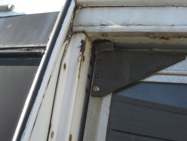

Over to the bus doors. When we got this the polarity switch to open and close the doors was shot. And they used a bungee cord to hold the door closed (you can see in the upper left - plus heres a lovely view of the nasty original seats):
Thankfully one of our friends works for a local bus company and one of their mechanics were able to rig up an up/down toggle switch with new parts for $100. This at least opens and closes the door without needing any goofy cords or manual release. But the downside is that when driving the doors themselves do not stay put. They're in bad shape so I'm still at a loss on how to address:
