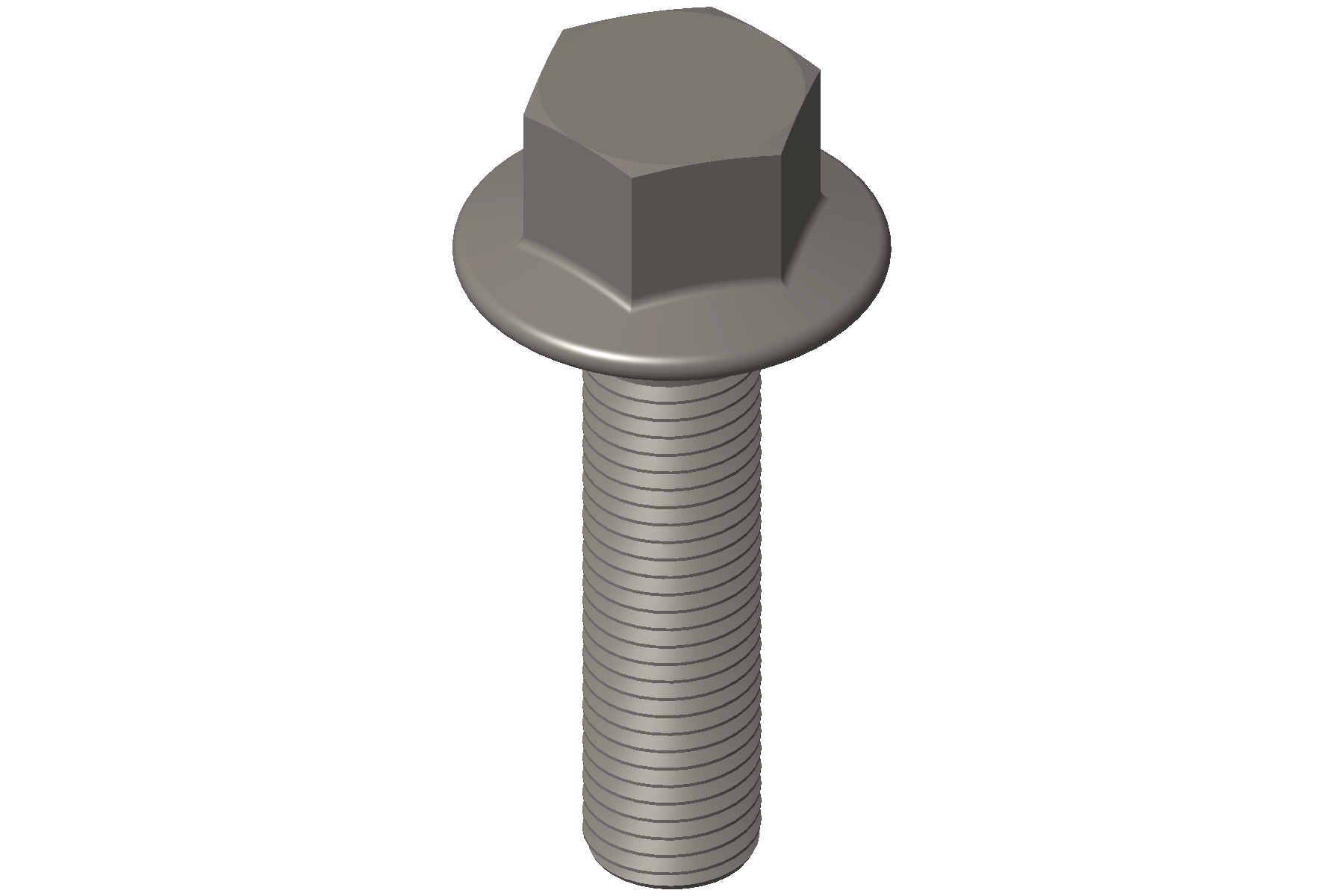

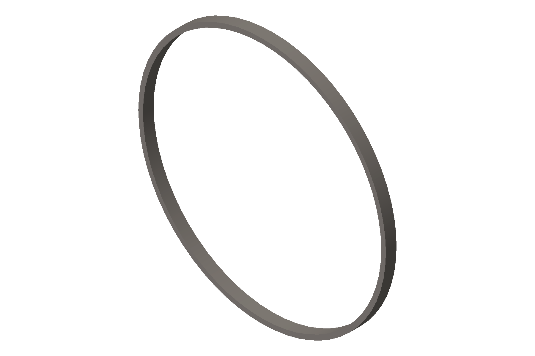

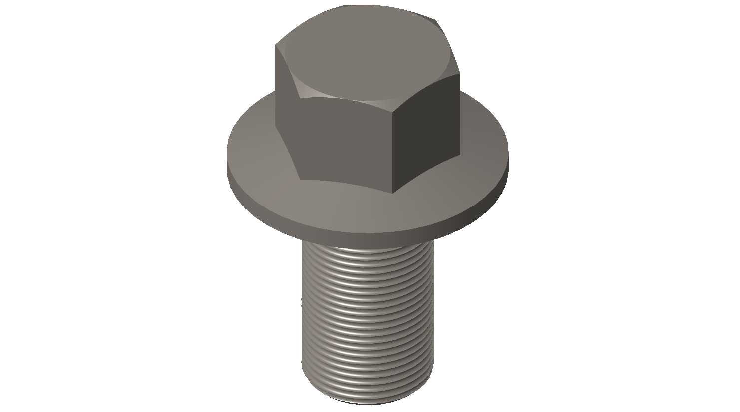

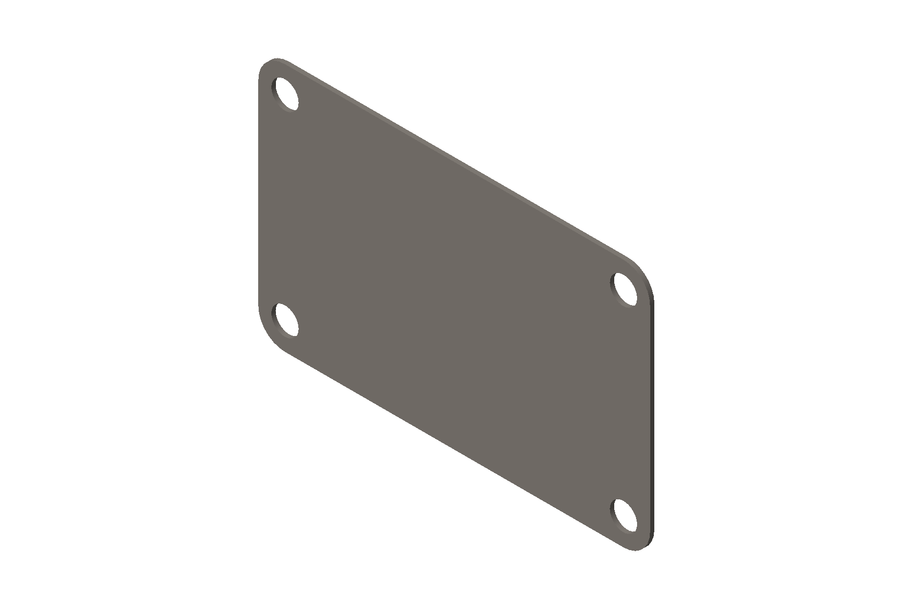

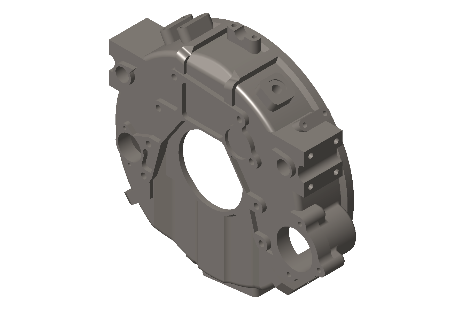

I have a 3060 mated to an ISB. Below is the info for my setup. You will need the SAE2 housing if you go to the 3000 series or MT643.
Component Number Description FTR RIGHT FILL TUBE OR PLUG RSN NO REAR SUPPORT BRKT. 01-806 MAIN HOUSING GROUP 02-636 W/O FILL TUBE & DIPSTICK 05-598 MAIN SHAFT MODULE (CR) 08-756 SPCR 1610 HALF RND YOKE 10-603 OIL PUMP STD W/O PLATE 14-1003 P1 PLANETARY MOD (CR&WR) 15-509 P2 PLANETARY MODULE (CR) 16-1734 CNTRL VALVE MD 4" W/O OLS 20-521 FRONT REMOTE PROVISION 21-935 TC411 CONVERTER MODULE MD 24-780 TRNS SE CUMMINS "B", 6 BO 25-539 ROTATING CLUTCH MD STD 34-542 CONVERTER HOUSING STD 39-673 MD REARCV CR NO TACHO
Cummins has all the parts for the SAE2 housing listed below.
Option:FH9161-04
Option Notes:
Flywheel housing
Wet/Dry clutch: Dry only
Housing Material: Aluminum
housing SAE size or type: SAE 2 starter mount holes
angle (deg): 90, 180 starter
mount hole thread size: M10X1.5-30 deep
Starting Motor Location
(deg): 259 starter motor
center distance (mm): 234.2
starter pad offset from rear
face of block (mm): 0.00
required starter pilot bore
(mm): 88.9 trans MT holes
theard size: M10X1.50-6 h

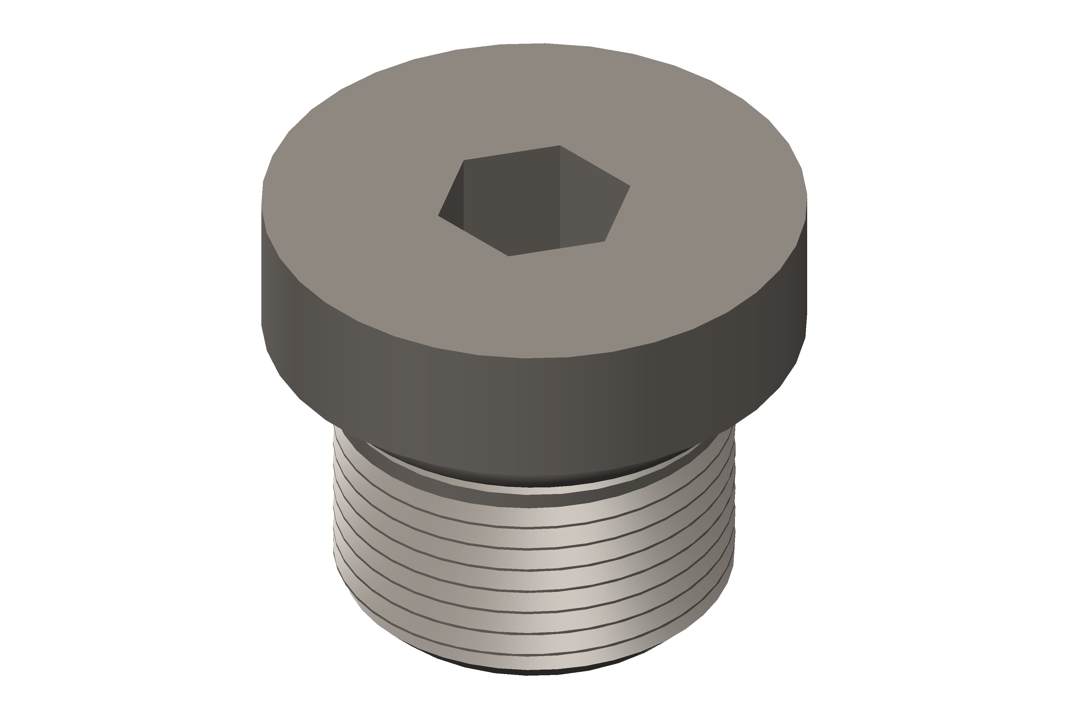

3904181
Threaded Plug13/4 - 16 Unf

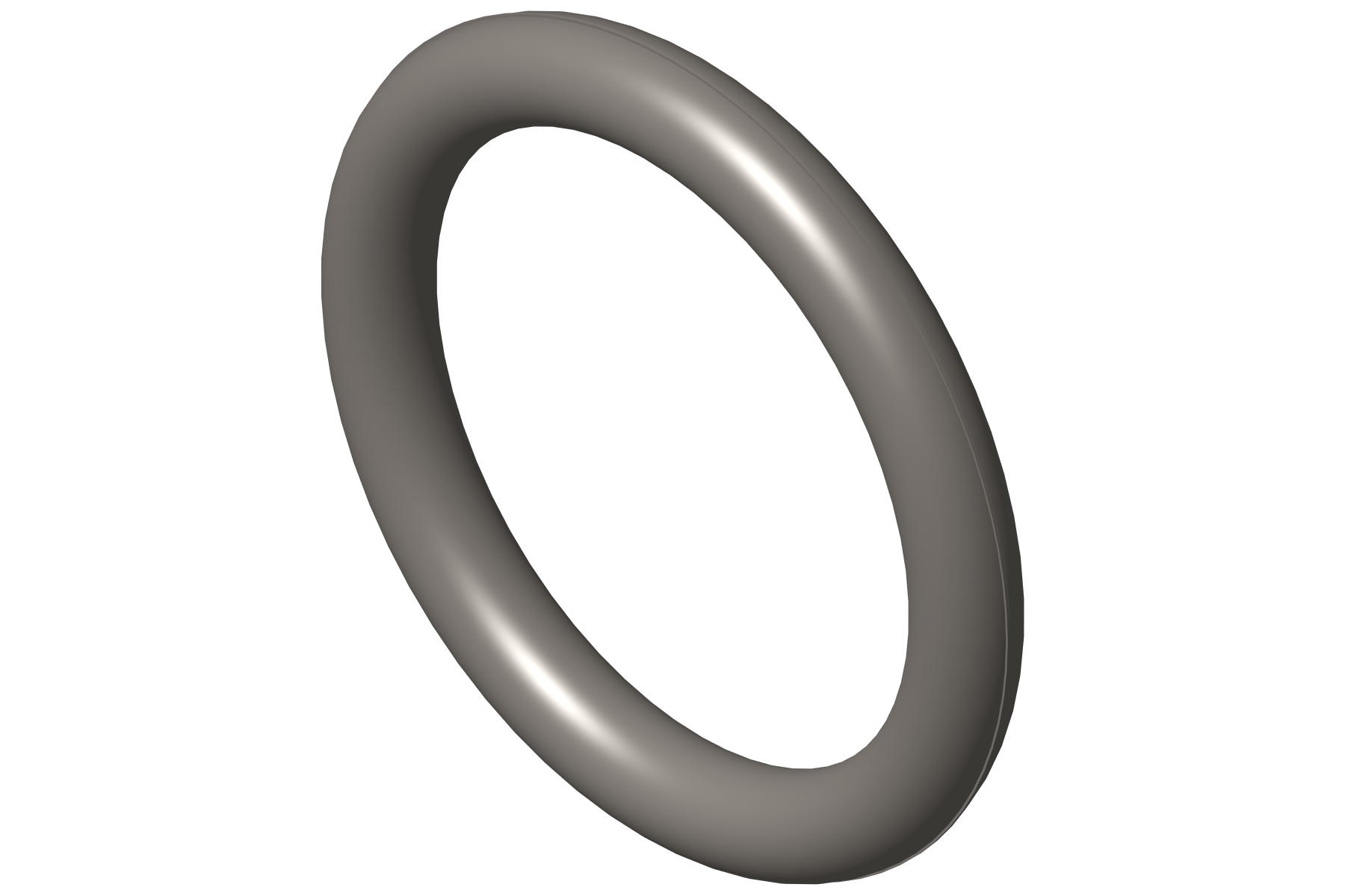

4
3910248
O Ring Plug2
5
3910260
O Ring Seal2

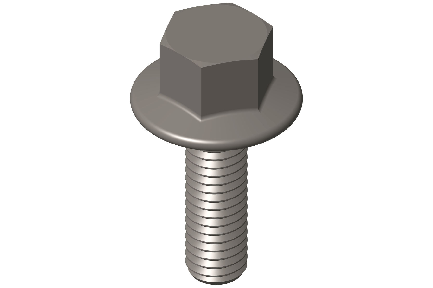

Screw, Hex Flange Head Cap6M6 X 1.00 X 16.
11
3920447
Screw, Hex Flange Head Cap8M12 X 1.75 X 40.

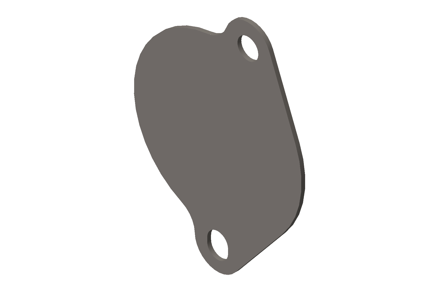

12
3925234
Cover Plate1

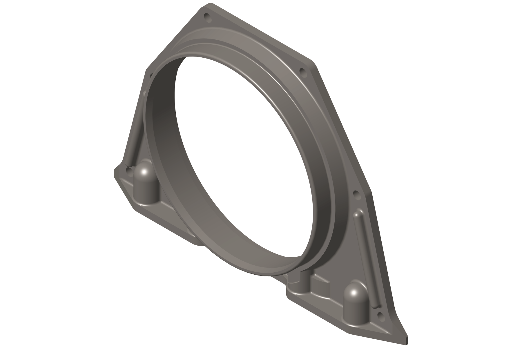

13
3931713
Flywheel Housing1
