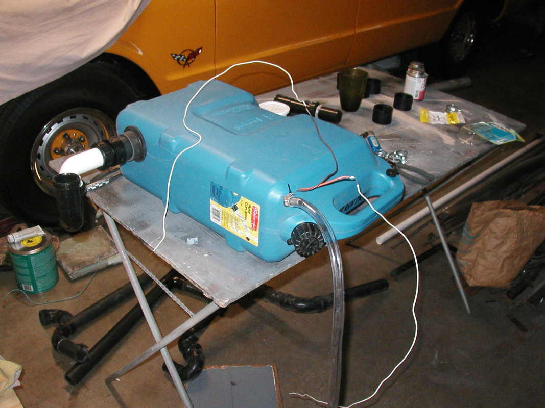

My shower is a step down affair so needed a lift pump to raise the shower water to the indoor grey tank. I installed a 12v submersible pump in the shower's waste tank to lift the water to the grey tank. It works just fine. I am cautious not to let much in the way of solids like hair get into the tank.
Jack,
Thanks for the reply and the great pictures!!
In your set up is the pump automatic or do you just switch it on as needed?
I suppose a little mesh filter where the water drains out of the shower would keep out the gunk and spare your pump a bit.
Mark

Mark, I just used a waterproof bat switch in the shower stall and yes a fine mesh screen works to keep junk out of the pump. Depending on the design of your tank a marine bilge pump would also work but it might sort of be over kill.
