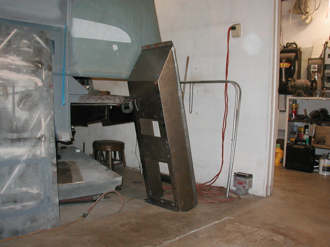

I have the same Ecotemp as discussed in the article. When I first began using it the burner would often shut down despite having proper flow and pressure. "Mike" was contacted and with his help I re-set the factory gas/air mixture and the heater has operated flawlessly since.
Knowing the heater was designed for outdoor use and since I didn't want the heater on the outside of my bus, I designed a steel heater cabinet for inside the bus, The cabinet is sealed to the inside, gets all combustion air from outside the bus and exhausts completely to the outside. I've added a thermocouple to the outlet water line that shuts the heater down at my pre-set temp.
I chose to vent the heater through what was originally the left rear quarter window and to draw combustion air in through the floor.
Here is a pic of the heater with its exhaust hood (matched to the bus contours) and the vent screen (placed in the floor to keep critters out).
This is the initial installation. I also installed the two water pumps there. You'll notice that I kept the steel inner body panel to mount the heater on. I used high temp insulation between the inner and outer walls behind the heater--otherwise I used 2" of foam insulation throughout the bus.
This pic shows the steel cabinet that covers the heater and pumps and isolates them from the interior of the bus. There are two access panels in the face of the cabinet securly secured by screws and insulated against leakage.
With the bus now complete you can see the water heater cabinet on the rear wall of the bus behing the slide out.
